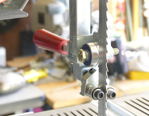

Josh,
This is a pic of the top Carter Guide Bearings on the SS and I am using a 5/8" blade. You will need a SS Guide Block Bracket #5025779 to get all of your measurements. The #5025779 fits the top and bottom of the saw. This should give you a relative size of the components.
LDH
