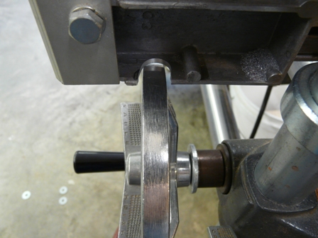

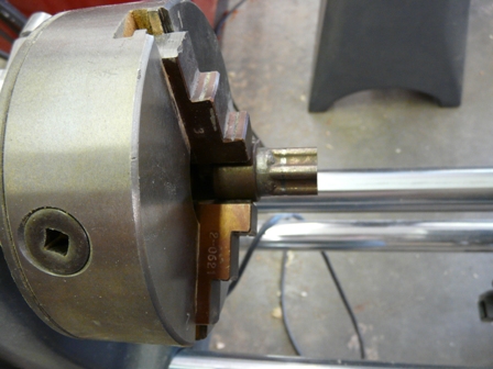

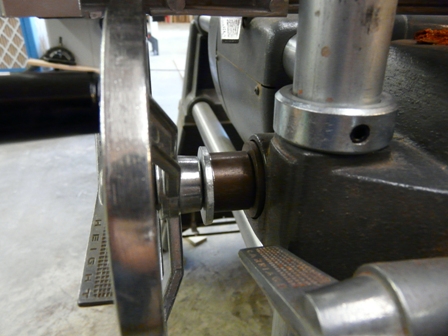

This is a Mark 5 upgrade of my own design. After busting knuckles several times removing the lathe tool rest, I decided to replace that little red handle with a model 520 hand wheel. I played around with the hand wheel off of my 520 and discovered that it would work with some modifications. Mainly a small modification to the Mark 5 table because it will hit the hand wheel.

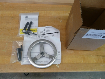

New parts from Shopsmith

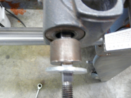

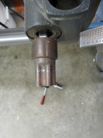

I will be cutting this off right where it steps down for the handle
[ATTACH]4787[/ATTACH]
[ATTACH]4788[/ATTACH]

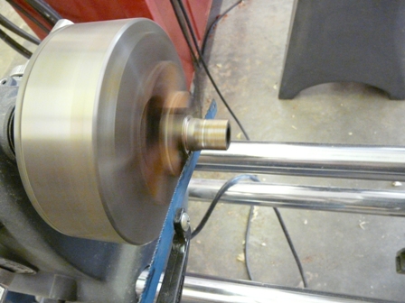

Chucked in the 520 I just held a hack saw while turning it at slow speed.
[ATTACH]4789[/ATTACH]

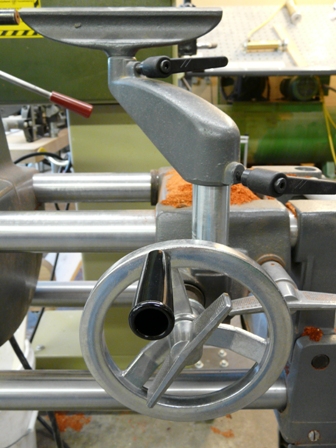

Now with the handle adapter cut down and a 3/8 washer as a spacer the mark 520 handle will fit.

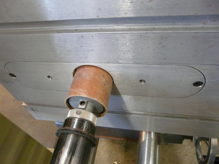

To get the table low enough in the drill press position for the sander to center I had to grind the table a little.
[ATTACH]4792[/ATTACH]
After getting it to work with the sanding drum I locked the table down with stop rings set at about 1/32 inch clearance.
[ATTACH]4793[/ATTACH]
The upgrade is complete with upgraded tool rest.
If Shopsmith would make a hand wheel 1 inch smaller than the 520 it would be a good seller!:)

The picture you refer to is showing the table position for the drum sander to work. I had to grind the table to get it to lower into that position.
Mark
