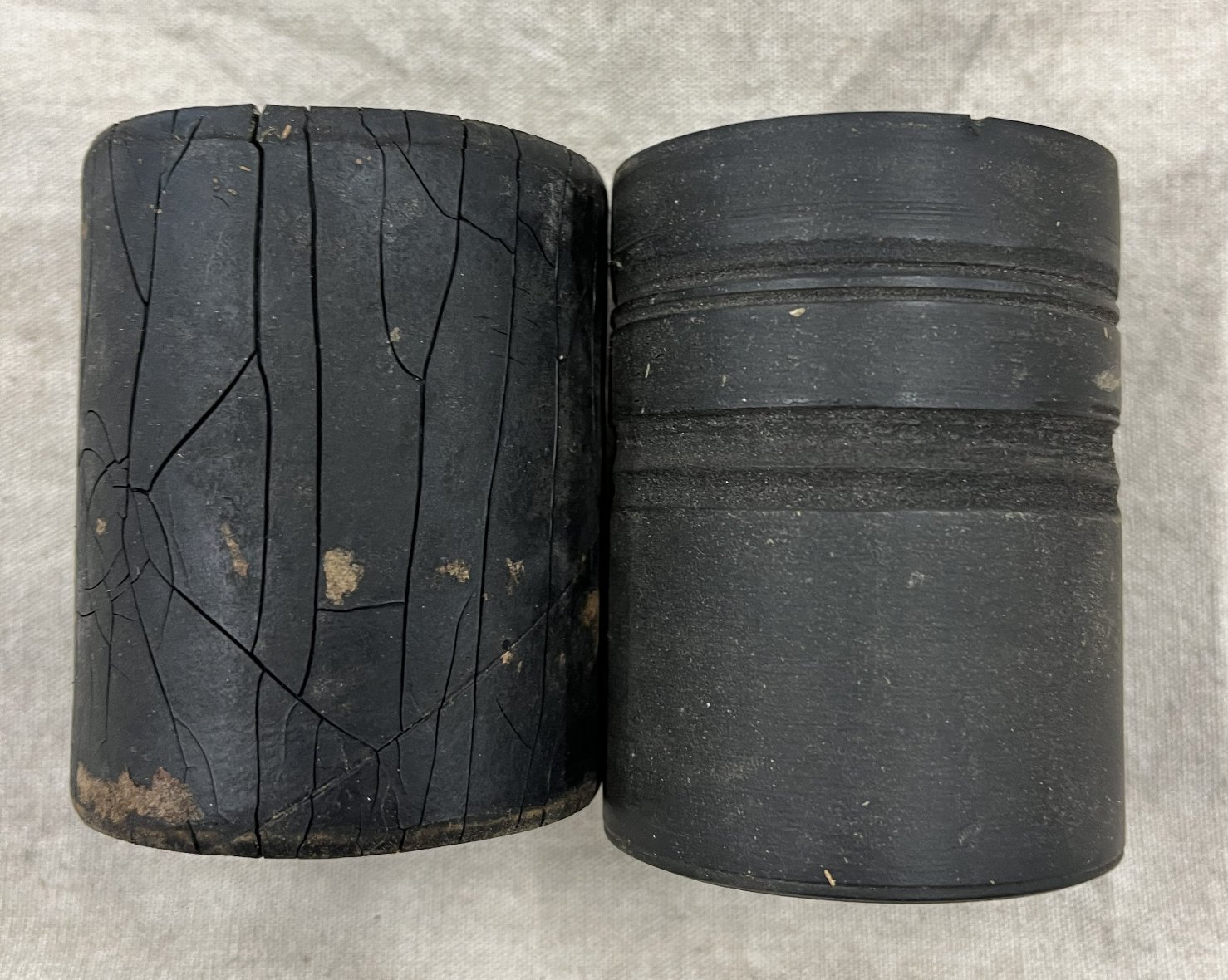

So, what do you do if the rubber Sleeve on your Drum Sander begins to look cracked, oddly worn or becomes too stiff to compress and hold the Sanding Sleeve. The cracked and oddly worn ones below are to examples I have had. Most often the problem is they are simply too stiff to compress.

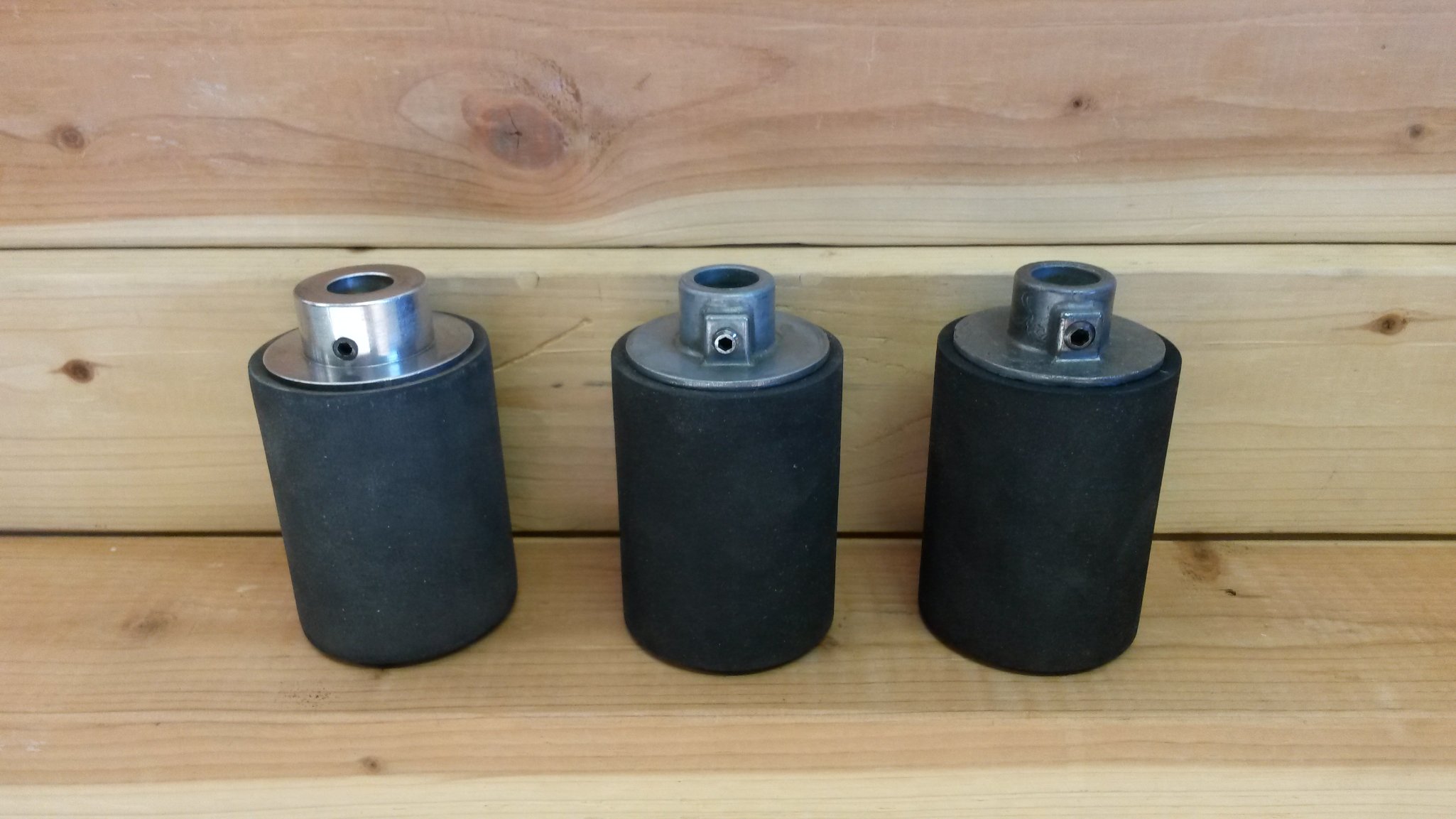

I have had this problem on several Drum Sanders I have acquired with Shopsmith's I have restored. Below are the three versions of the 2-5/16" Shopsmith Drum Sander going back to the first one made for the Model 10E which is machined aluminum. the middle is the cast one for the Model 10's with the 1/8" Allen Wrench size set screw and the third is the cast one with the 5/32" Allen Wrench (Shopsmith toolbox) size set screw made beginning in 1954 to present.

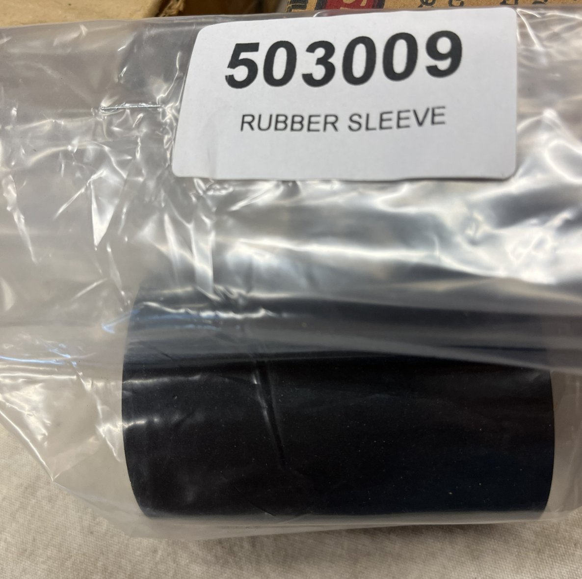

You may notice the rubber Sleeves on these that look like new. It is because they have been replaced with new sleeves like the one shown below. This is an easy way to renew your Drum Sander to work and hold Sanding Sleeves like it is brand new. The only difference from early rubber Sleeves to the current one is a change in the rubber compound. I believe that change is an improvement that could make the rubber Sleeve last longer than previous versions of the Sleeve.

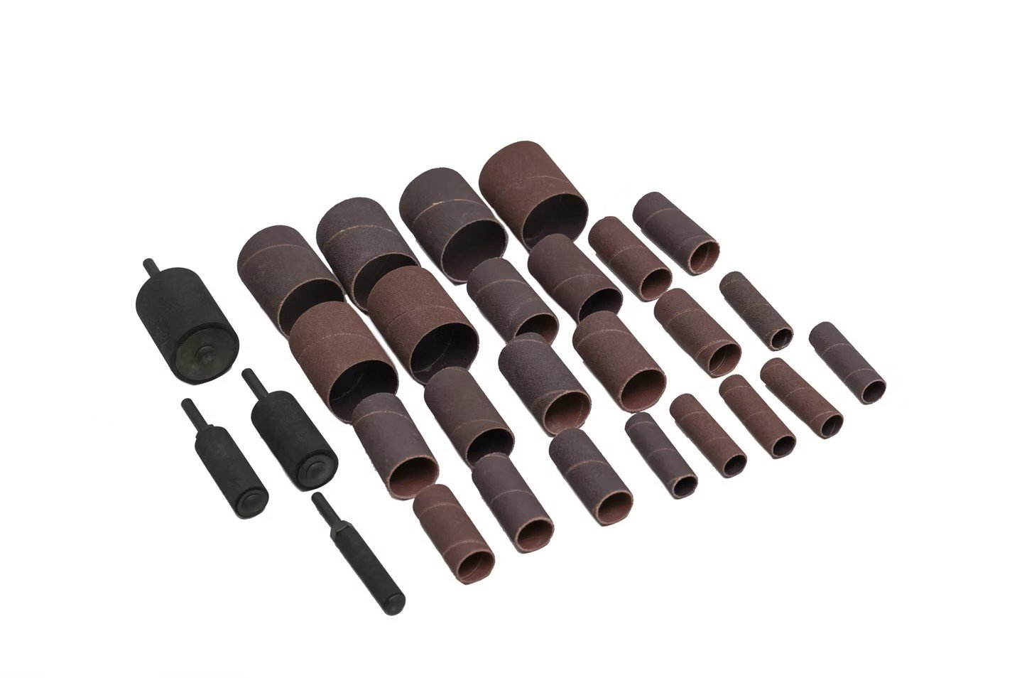

Below is a picture of the 28-piece Drum Sanding Package Shopsmith sells. These are smaller both in height and diameter but can be just as useful and in some cases more useful than the Shopsmith 2-5/16" x 3" Drum Sander.

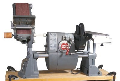

I know some have set up a Sanding Station with a Shorty or Shop Deputy like Shopsmith's suggestion pictured below. A Sanding Station can be set up on a full-length Mark too. The Sanding Drum is a useful part of that station. But you have a Shopsmith which as we know is a very versatile tool. Instead of using the Shopsmith Sanding Drum you could use another Sanding Drum mounted on the Drill Chuck. Unless you have a specific need for a
2-5/16" diameter Drum Sander continue enjoying the ones you have. Besides having several of the 2-5/16" x 3" Sanding Drums I have the 28-piece Drum Sanding Package mentioned previously and the 2-5/16" x 6" Drum Sander. They all have times when each one is the best choice for the job at hand.
