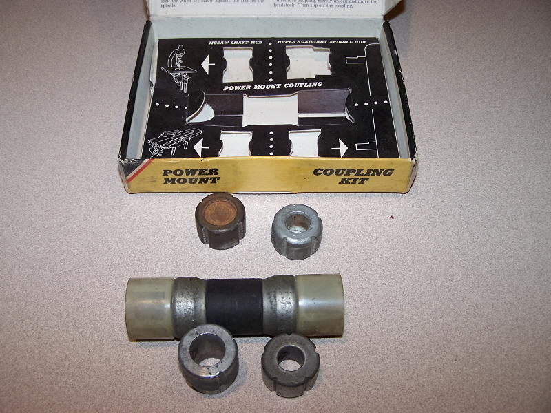

I have one of the old old couplers and hubs (see picture). In my kit the SPT 1/2" hubs have 5 grooves and the 5/8" spindle hubs have 4 grooves. Meaning that the coupler can only go one way. But it looks like in the new kits both hubs have 4 grooves. http://www.shopsmith.com/ownersite/part ... xpview.htm
Is that correct? If so, I could put a 5/8" spindle hub on the jointer?
Hmmm, maybe I'm back in business.

- 100_1169.JPG (406.92 KiB) Viewed 6967 times

The bandsaw and the belt sander are two of the SPT's that have 5/8" input shafts. You want a hub with 5 grooves.

The Coupler hubs come in four varieties(there are other slight variations).
Two varieties have 5 grooves and the other two have 4 grooves.
The 5 grooved ones are intended to be mounted on the spt. There is one to fit a 1/2" shaft(ss jointer and one of the 'jig' saws) and one to fit 5/8" shafts(everything else).
The 4 grooved ones are intended to be used on the headstock output shafts. The longer one(has a bore all the way through and an elongated shoulder) is intended to be mounted on the UPPER shaft with the shoulder towards the headstock end of the shaft. The shorter with a blind bore is intended to be mounted on the idler shaft for use with the ss jointer and compressor(not currently available).
The coupler is mounted on these hubs with the spring end(4 nub) towards the headstock and the open end(5 nub) towards the spt.
