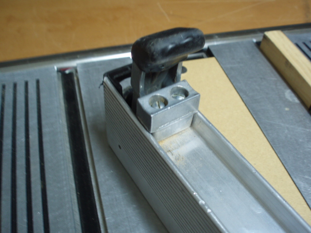

I have not had any experience with this being a problem when locking the 510 rip fence, but the actual locking lever may be malformed. A close visual
inspection should tell for sure.
[ATTACH]6185[/ATTACH]

- Posts: 35457
Dusty has given you very good advice/direction. I add the following to hopefully ensure you understand several of the 'details'(that IS where the devil resides).
1) The fence is aligned to the TABLE miter slots.l It is set parallel to them.
1a) The TABLE is set parallel to the BLADE in an entirely separate procedure. BOTH the fence and the blade must be set parallel to the miter slots in order for the fence to be parallel to the blade. Both ARE referenced to the miter slots. These separate adjustments MAY be performed in either order, but are typically done table to blade then fence to table.
2) As Dusty has said, all things MUST be straight. On a 510(or a 520) the rails are NOT adjustable to the table except in a vertical direction(early 510s are not adjustable at all)[they be the ones with holes on the front face and NO nuts inside the front edge(bolts accessed through the holes are screwed into Tapped holes on the front edge)]. If adjustable, the vertical adjustment needs to be done before the fence alignment.
3) As has been mentioned, the set screw on the right side of the clamp frame needs to be backed out so as to completely clear the rail. Removing it completely while aligning will insure it does not contaminate the process. Put it back AFTER alignment, but it still needs to NOT contact the rail. Here I deviate from Dusty's recommendation - Adjust it well AWAY from the rail. It is only used to intentionally pull the BACK of the fence out of parallel for certain rarely performed tasks.
4)There are 4 bolts that are loosened for adjusting the fence. The two in Dusty's pix are NOT the ones that align the fence to the miter slot. Those two screws hold/position the concave foot that rests on the rear rail. It needs to be adjusted AFTER the fence to miter slot procedure is performed.
5) The bolts that hold/position the fence to the front frame are accessed from the under side of the fence. They are two bolts with 5/32" hex socket heads. They need to be loosened, but the inside one needs to be finger tight(snugged up). It will act as a pivot as the fence is aligned to the miter slot. This 'inner' bolt is NOT accessible with the fence on the rail&table. Only the outer bolt is accessible from between the table front edge and the back side of the rail(from underneath the table).
6) Position the fence with the edge directly above the edge of the miter slot. The insertion of a board as Dusty suggested is a fabulous idea. Otherwise eyeball/feel it(not as accurate). Then push the fence clamp against the rail on BOTH sides of the fence and tighten the wing bolt. After verifying the fence is STILL parallel to the miter slot, from under the table tighten the outboard hex socket headed bolt(accessed between the rail and the front edge of the table). Verify again!.
7) Release the wing bolt, carefully remove the fence from the table and tighten the inner hex socket headed bolt.
8) Put the fence back on the table&rail and position the fence again directly above the miter slot and tighten the wing bolt. VERIFY the fence is still aligned parallel to the miter slot.
9) Examine the concave foot at the rear of the fence and make sure the concave foot can rest squarely on the rear rail and go down on it fully. If not, loosen the two cap bolts, finger tighten them and after re mounting and clamping the front of the fence, gently push the fence down firmly enough so as to cause the foot to align to the rear rail. Remove the fence and tighten the foot. Recheck the foot alignment.
10) With the front clamped down, slowly actuate the rear clamp lever. The rear clamp should move into the rail and draw the fence down to the rail. It should be tight just before the clamp reaches its maximum position. If not, loosen the two screws holding the rear clamp adjustment nut washer(it fits over the nut and has a hex shaped center hole). This will allow adjusting the rear clamp nut. Adjust the nut so the clamp just tightens the rear clamp as the lever approaches its maximum position. If too tight, excessive wear of the lever cam surface will occur. Too loose and the rear clamping will be inadequate. Finally retighten the two screws securing the 'hex holed' washer.
IF this does NOT make the fence parallel to the blade, then the TABLE to BLADE alignment needs to be performed. Dusty has pointed you to relevant info already. (In addition the table trunion stops should also be done to ensure the blade cuts at a right angle to the table ETC.)
Probably more than you wished for, but all these detailed adjustments ARE what gives you a properly aligned SS.
If you need 'more' help, we will be here as today.
