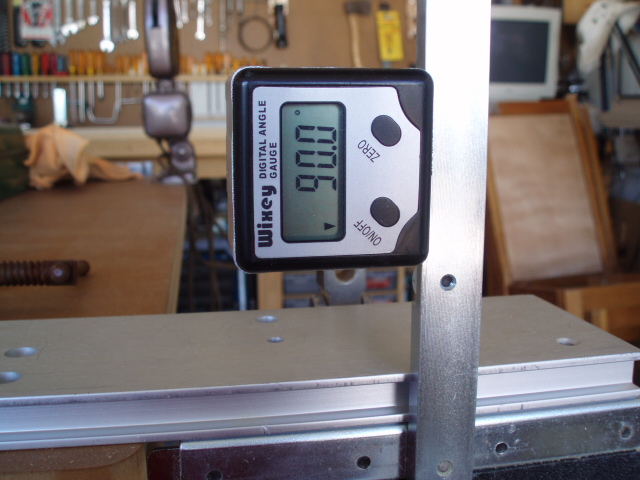

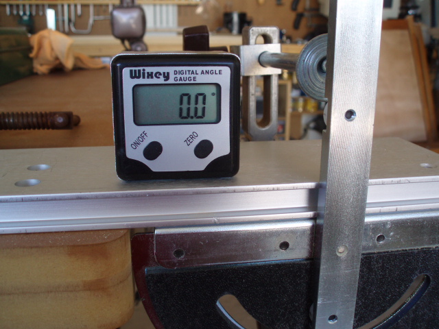

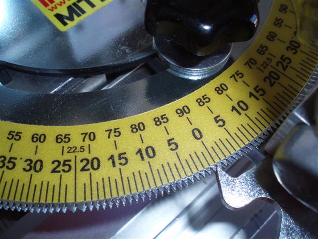

The V120 is a terrific accessory and serves well as a point of reference for the table alignment. I set the V120 for zero degrees and then checked it with the MiterSet and with a Wixey. The V120 was dead on.
[ATTACH]6190[/ATTACH]
[ATTACH]6191[/ATTACH]
[ATTACH]6192[/ATTACH]

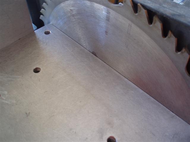

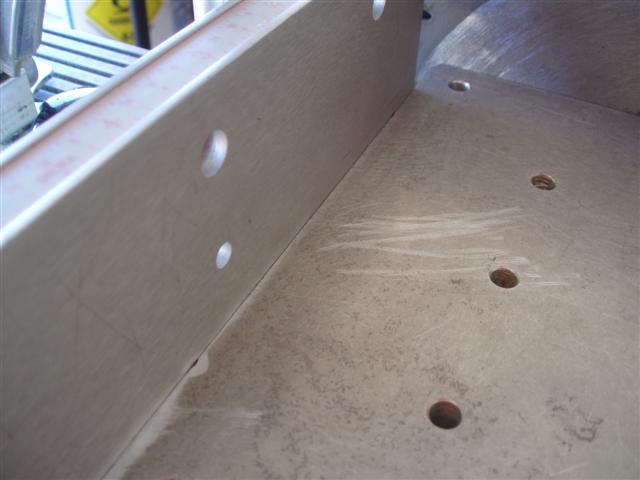

For this alignment, I chose to use a piece of milled aluminum in lieu of a square. I know this piece to be perfectly square, it is a good size and weight for use here.
I loosened the four studs that secure the main table to the trunnions. I then inserted a dollar bill behind the trunnion (per Nick's tip), set the table to zero tilt and mounted the V120.
I then used the aluminum piece to position the table, squaring the table to the blade using the aluminum piece (the square).
[ATTACH]6193[/ATTACH]
[ATTACH]6194[/ATTACH]
I tightened the studs that secure the table.
No dial indicator, no Wixey (except to validate the V120), no feeler gauges and no fooling around tapping here and tapping there to position the table. The table was simply moved so as to position the aluminum piece against the blade and the miter fence.
The fence is perpendicular to the blade and the blade is parallel to the miter track.
Checking with a feeler gauge, I cannot insert a .002" feeler between the aluminum piece and either the fence or the blade.
Don't forget the dollar bill.

With regard to the piece of aluminum - let me emphasize the fact that this is not "required". The exact same process can be utilized using a piece of wood that has been squared. In fact, the procedure can be done using a square.
I now prefer this method because I can lay the aluminum (the squared block) on the table, push it tight against the miter fence and then the blade and begin alignment. The evidence of error that needs to be corrected is right there in front of you. Just move the table, as required, push the block back into the corner to confirm corrections and you are done.
