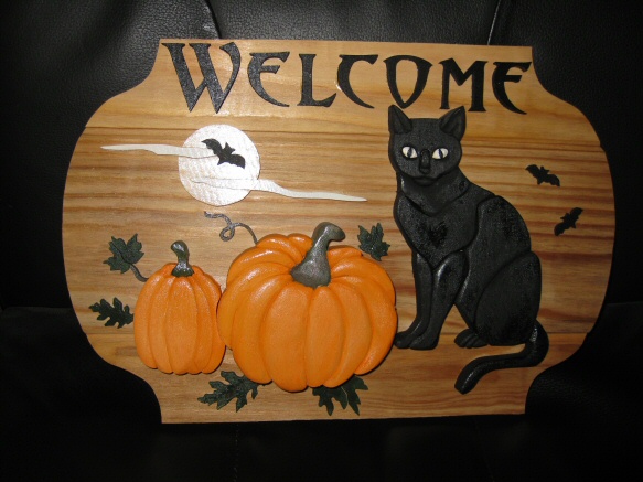

Happy Halloween. Sign made for my daughter's home.
Painted Basswood overlay on redwood fencing.
[ATTACH]6371[/ATTACH]
Halloween 2009 resized.jpg (110.96 KiB) Viewed 2437 times

She ought to like that! Great looking shingle, Gary!

Beautiful job!!!

Great job, Gary!
Hope there are lots of goodies ready as it should attract a crowd.

I agree that this is a great job.
Are the pumpkins relief carved, or is that all in the paint job?
Thanks, Mike
What a sign!!!!
WOW! Beautiful sign, Gary! Your intarsia looks terrific, as usual. Don't know how you did the painting, but that doesn't matter. It is simply gorgeous!:D

Beautiful sign, nice job.

VERY NICE! Way to GO!

I have the same question. Is it like a puzzle with the pieces glued in?

Pretty much so. Each segment is cut like a puzzle out of blocks of basswood. Then the pieces were individually sanded to reduce the thickness and rounded with a dremel. After painting the face of each piece the puzzle was glued onto the redwood backing. The bats and leaves were cut on scraps resawn to 1/8 inch. The moon and clouds were 1/4 inch stock, also from scraps. It's time consuming, but allot of fun.
