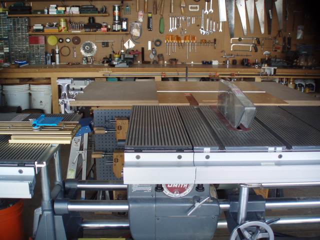

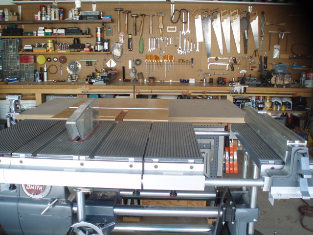

The extension tables at both ends are very valuable. Some complain that the Shopsmith lacks table space. That is true if you allow it to be. You have solved the hard part by upgrading to the 520. I have added the extension table to the left side as you suggest but I kept the floaters. I believe you should give that some thought too.
[ATTACH]6651[/ATTACH]
My most used set up is with the right extension and two floaters. This makes for a lot of table space with added support available on both side of the blade. You see the floaters, left and right of the main, and the right extension here.
[ATTACH]6652[/ATTACH]
I use the left extension, simultaneous, for other functions - most often the router table. You can't see the router table in this picture but that is what is attached to the left.

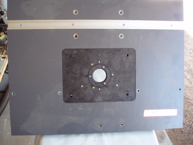

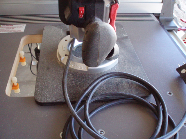

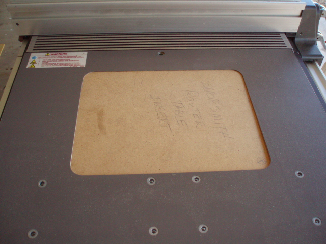

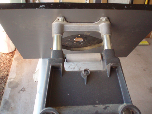

tryinhard wrote:Dusty,
Would you post a picture of the router table?
Thanks, Mike
I have two:
[ATTACH]6659[/ATTACH]
[ATTACH]6660[/ATTACH]
The first mounts like an extension table and
[ATTACH]6661[/ATTACH]
[ATTACH]6662[/ATTACH]
The other mounts like a floating table. However, when I use this one it normally is mounted off the left end of the Mark V supported by the telescopic legs.
