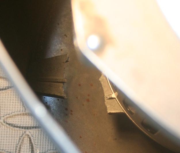

Bill,
I removed the belt cover as you suggested and found that one of the motor mounting brackets was broken. I have included a picture of it. Also one motor mounting screw was missing as well.
Will I need to order a new bracket? If so, it looks like I will have to apply some force to get the motor back into position, seeing as how the motor is under tension by the belt. I'm not sure how to do that.
Thanks.
Chuck

I am not sure Shopsmith has anyone to quickly rebuild headstocks or if they still do. I would believe they will have to free someone up every week or two to catch up for this type of work.cincinnati wrote:Not to get off topic but always wondered. Is that e-bay guy a lot cheaper than sending it to Shopsmith for repair? Why not have Shopsmith do it?
I am not sure a new bracket can be ordered. Is it not part of the motor?
You cannot order the broken part. I have not had any success trying to weld the leg as the metal is a combination of aluminum alloys (like pot metal). I like to buy bad and broken motors just to get these unique parts. Contact me off-line if there is no insurance or adjustment from the repair person or you need help.
- Posts: 35598
If I am seeing the pix properly, the bracket broken is the one on the back end of the motor(end opposite the output shaft). My 510 has a different bracket there(steel bolted to the motor shell). This is a stout steel bar that could be fabricated to fit. However if you sent it off for repair, that may not be something you want to get into. In any event, you will need to remove the motor the first step of which is to remove the drive belt. I am a bit concerned that the pix(and your description of the interference putting it back on the way tubes) indicate a shift in the motor position. If the bolts are not loose or broken, how can it be displaced that much with only one bracket broken?
Based on when I tore down my headstock, whatever impact hit the motor area during shipping probably twisted the motor pan. You'll probably have to do some gentle persuasion to get everything realigned.
