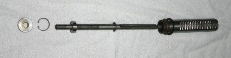

Gilmer pulley and bearings
On the model I have, the Gilmer pulley with two Allen set screws is too large to come out of the bearing holes. I assumed the bearings and shaft were an assembly as well. From a few pictures I have seen of other posts, it appears as an assembly. The belt pulley is far too large to be extracted from the bearing holes. After I removed the shaft, pulley and bearings, I compared sizes from the outside and confirmed the pulley is too large. Perhaps my pulley is not appropriate for this Mark V, but the machine ran without an indication that the pulley was a problem.

Greenie is older than your model.
Thanks for your pictures and post. My machine is older, without a clutch on the Gilmer drive. My Quill looks exactly as the one you pictured. My Gilmer pulley does not closely resemble the pulley with a clutch.
I viewed another post with pictures and that also shows the clutch model. I must have a model earlier than 1956.

Thanks for the posted links. My model is 1956. I will attempt to provide pictures.

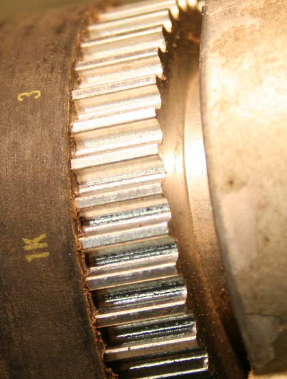

Pictures of Gilmer from early model
The Gilmer pulley issue has been resolved. However, several of you have not seen a pulley without the clutch feature. The pictures I post show that an aluminum pulley constructed of one solid piece with stamped numbers from a production run exists for the Greenies. The pulley is larger in diameter than the clutch models which does not allow the pulley to be removed through the bearing holes.
