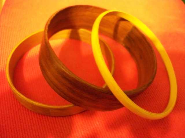

Following-up on what Ivan wrote, I recall making bracelets over 20 years ago using veneer. I would boil the veneer, strips 1 x 18 inches or longer, in water for five minutes or so till they were pliable and then wrap the veneer around a can to dry, securing them with copper wire. I'd place the cans on a wood stove so they'd dry quickly. After dry, I'd apply wood glue where the strips overlapped, using a couple of strips to increase the thickness of the bracelet, wrap them around the can again, secure with masking tape and let dry. Then I'd mount them on a mandrel on a lathe, use a skew chisel to clean up the edges and cut them into narrower widths, sand, finish, etc. Here's a picture of a couple of the bracelets:
[ATTACH]7508[/ATTACH]
What I don't recall is if the veneer would be pliable enough to wrap around a mandrel as tightly as needed to make a nut for the fly rod, but I'd suspect that some veneers would do it. I've also used thin CA glue to harden wood so that you can use a 10-32 tap to thread wood that has held up well over several years.
