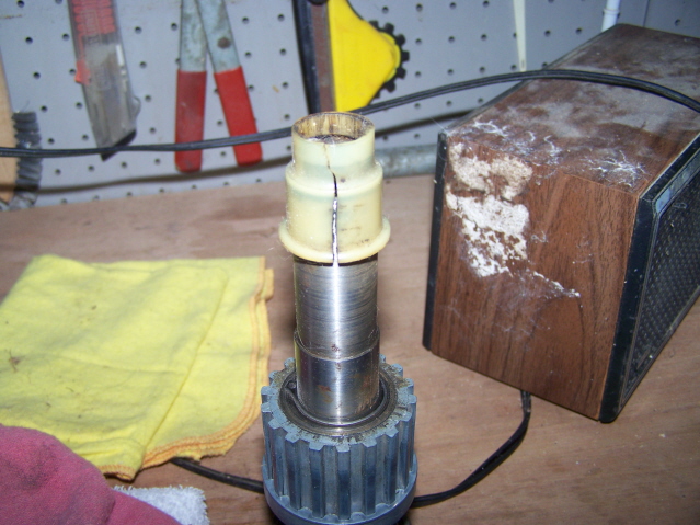

Ron309753 wrote:If it looks like this it's Item #57.
Sincerely,
Ron309753
That is what a 'broken' gilmer version looks like.

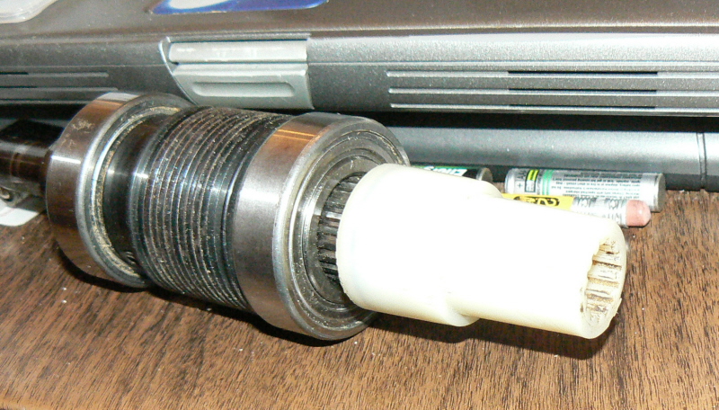

This is what a poly v version looks like.
[ATTACH]7805[/ATTACH]
- nylon sleeve.jpg (285.52 KiB) Viewed 6477 times
