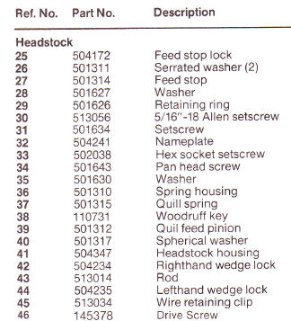

The Mark V manual that I have has different parts for the ref.# indicated above. Notice 26 thru 45 above compared to this:
[ATTACH]8803[/ATTACH]
dusty....are you able to determine what version of manual you have? date?
I'm really hoping the Mark V's don't have different versions of the manuals with different part ref: #'s and different parts.
- Mark V PL.jpg (31.98 KiB) Viewed 4671 times

Tis true! 'ref #' do vary! Must compare exploded views for comparison!!! And then there is the 'online' version!mickyd wrote: . . .

Although all the ref. # and some of the part numbers differ from the Mark V manual, the actual descriptions and sizes are "similar" EXCEPT, item 9, 504153 which shows a 1/2"-18 thread. Standard 1/2" thread pitches are 1/2"-13 for course and 1/2"-20 for fine. That set screw one would require a physical check before assuming it's an 18 thread per inch version. I assumed it was -13 course for my database.dusty wrote:The part numbers in my list came from the online catalog that I have on my computer. I down loaded this catalog when the pdf first became available (I guess about two years ago). I have not done a comparison with the hard bond catalogs. I never expected there to be any differences.
