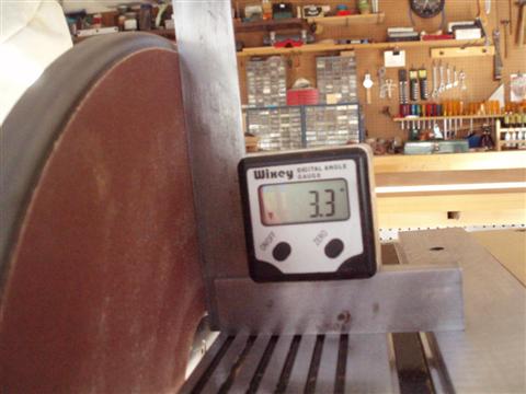

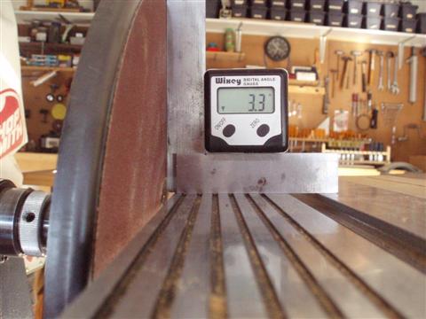

[ATTACH]8826[/ATTACH] [ATTACH]8827[/ATTACH]
Sand paper installed may effect the reading some but not that much.

Mine is not either, but does it matter as long as it is still conical? As you have shown, you set the table using a square. If necessary you can make adjustments to the table angle when using the jointer/planer knife sharpening jig. You might already do this if you want a more acute grind on the blades.dusty wrote:Not My Conical Disk

Yes, that is certainly possible but there is no bubble. I have checked this without paper installed and get the same reading.dasgud wrote:is it possible there is a bubble or high spot right there to affect the reading?

My conical disc is also just shy of 3-1/2°. Wixey just resolved just how shy. Where this comes into play is obviosly setting the table angle. I use a square to set it perpendicular the actual angle. If however you setting the table based on an assumed angle of 4°, it would be wise to verify it.

BUT what does it measure more towards the edge of the disk?
It ain't 4°! It is 3+°. The dimensions of Nick's thickness sander jig in a saw dust session ends up at about 3.2°.
Why SS insists on perpetually calling it 4° is a mystery(or they be like an ostrich).
Accept it! That IS the way it is! Use square to set table, and move on!
I also corroborate the conical disc NOT being 4 degrees. I didn't try my Wixley, but my gauge under table is set exactly to 0, so I just counted back 4 lines... I'm assuming, of course, that this gauge is somewhat accurate.
Regardless, I was getting a setting at a little over 3 degrees. When I tried 4 it was very easy to see that the results were not square.
