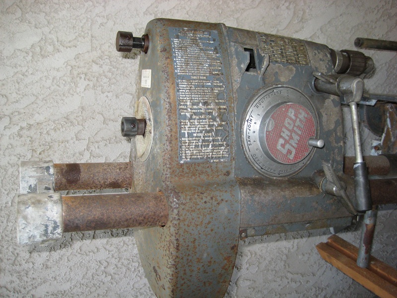

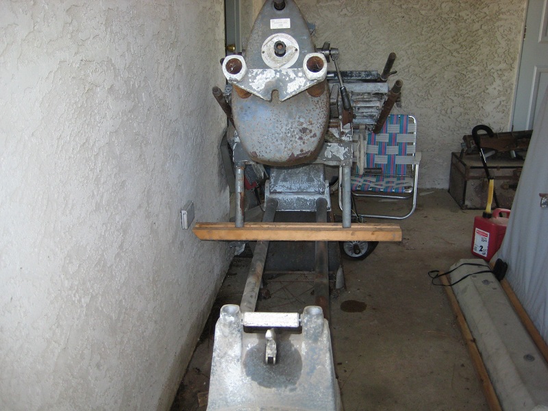

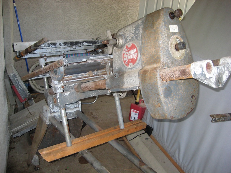

Hello all;
Been a while since I posted, but I would like to let everyone know, I completely rebuilt the shopsmith (thanks to all forum members) and I am posting some before pictures. I will take some after pictures soon to show everyone the completed job. I did have back surgery 2 weeks ago so anything I did not get done before that just will have to wait.
[ATTACH]9710[/ATTACH]
[ATTACH]9711[/ATTACH]
[ATTACH]9712[/ATTACH]
