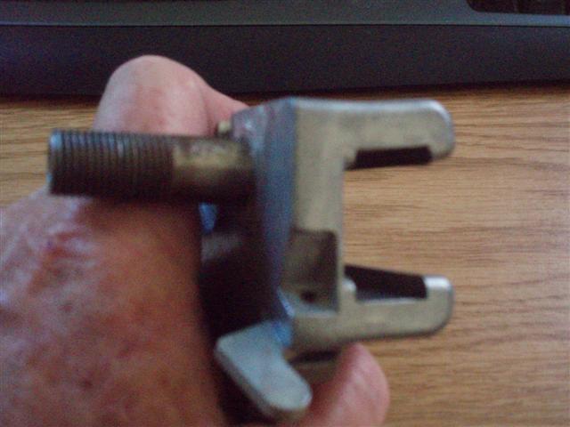

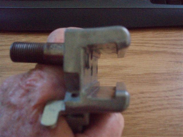

This was maybe the best repair expenditure I have made in a long time. I have put this off believing that the small amount of distortion in shape just could not cause a problem. I was really wrong.
The fence now sits like it should on the table, is easy to unlock and move and then repositions itself exactly like it should.
I think, as I have been told here on the forum, that my problem was caused by cranking down too hard on the fence lock mechanism.
[ATTACH]9195[/ATTACH]
[ATTACH]9196[/ATTACH]
I sure hope the new one holds up. The new one is not as heavy as the the original one.
P6110002 (Small).JPG (42.76 KiB) Viewed 2588 times
P6110003 (Small).JPG (42.72 KiB) Viewed 2585 times

I had replaced mine years ago when I was having trouble getting good joints. I tried everything that Shopsmith had told me to do without much success. Then I noticed a problem with the quadrant and replaced it. Voila! It was a successful cure to my problem. Good luck with replacing yours.
robinson46176
Posts: 4182
Post by robinson46176 »
dusty wrote:I think, as I have been told here on the forum, that my problem was caused by cranking down too hard on the fence lock mechanism.
I suspect that my son got a little tired of listening to me telling him back when I got my new 510 back in 1988 that Godzilla was not a woodworker... :) I kept telling him to tighten the locks tight enough to hold but don't crank down on them.
Me too, Dusty! For me, it was a hard lesson to learn that overtightening is very easy to do!:eek: The replacement seems to be holding up nicely. Have had it for about 5 :confused: years.
