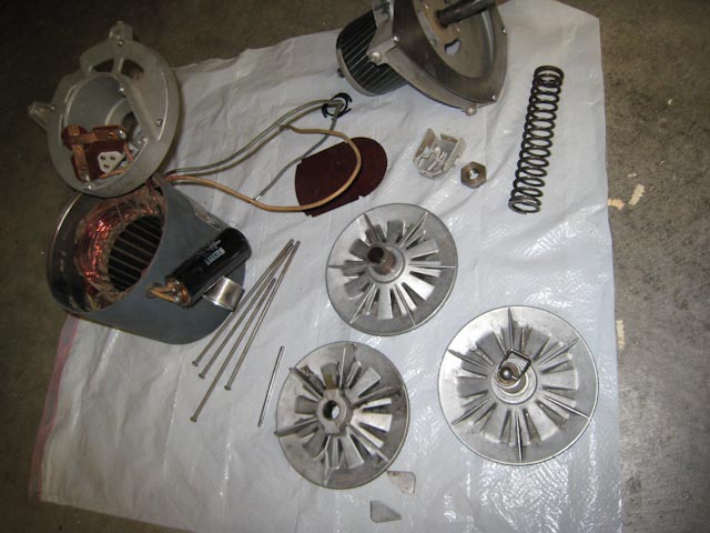

Success!
So I finally got the nut off. I ended up completely disassembling the motor (3/4 hp A.O. Smith). I then put the shaft into a vise and used a rubber mallet on the end of my wrench.
I am certain the nut hadn't moved in 50 years, so no surprise that it was so hard to get off...I can see why it was switched to the washer and clip setup.[ATTACH]10352[/ATTACH]
- Motor parts.jpg (86.78 KiB) Viewed 4139 times
Make sure the vise did not distort the shaft prior to reassembly.damagi wrote:So I finally got the nut off. I ended up completely disassembling the motor (3/4 hp A.O. Smith). I then put the shaft into a vise and used a rubber mallet on the end of my wrench.
