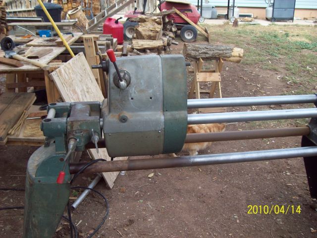

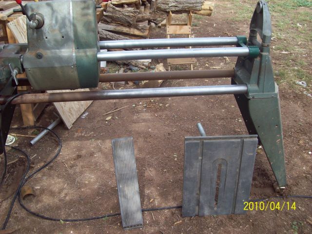

i was given this shopsmith. it has a serial num 295104 it has no top belt. i think it has been sitting about 20 yrs. no axsess hole to see inside , looks like gilmer belt,it has splines. is it worth restoring and can i do it. getting ready to retire and dont have a lot of money.i live in utah.

Yes, it is worth restoring and is easy to do even if you only have minimal mechanical ability.
Without an access hole there is really only one way to get into headstock and that is to remove the motor pan.
The first thing to do is to remove the belt cover and look at is where the v belt is on the lower sheaves (fan sheave and floating sheave). If the belt is not within an 1/8” of the edge of the sheaves (see attached picture) you will have to attach a sanding disk to the spindle and turn it while you slowly turn the speed dial to high. That will move the belt to the edge of the sheaves, and then you can work the belt off of the sheaves.
The next thing I would do is to remove the nut(s) holding the power switch in the headstock and push the power switch inside the headstock.
Cover the bench tubes with cardboard or carpet scraps and support the motor pan with a jack. Remove the screws holding the motor pan to the headstock and lower it onto the bench tubes. You can then move the motor and pan to a workbench to test it, check the wiring, and blow it out. Make sure that the power switch does not get hung up on anything when you remove the motor.
Once that is done you can work on the headstock as shown in the Sawdust Session. It would probably be easier to work on if you put it in the drill press (vertical) position.
Keep us appraised of yuor progress and we can give you some other pointers. Also, keeping all of the screws and parts in separate containers and listing the container where they came from makes reassembly easier.

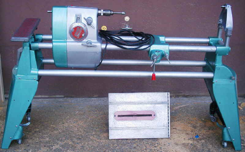

Recent Reactivation - Recondition
This is a recent reactivation that needed the replacement of a stripped Speed Control Quadrant to end the tripping of the circuit breaker when switched on and it attempted to start at a high speed setting. Medium Green Hammerite was used because Verde Green Rustoleum was not available. Rustoleum Hammered Silver was used for the Headstock.
These are excellent, machines and are easy to align and use.
