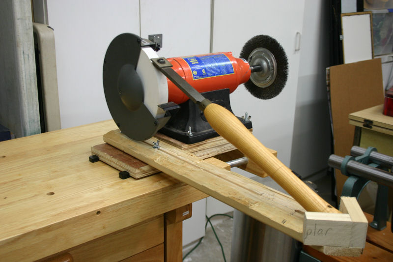

I can't take credit for the concept of this jig but I can take credit for using the cheapest piece of scrap wood anyone could find to make it with. I saw the jig on a you tube video and it was also posted at LumberJocks as the 'Poor Man's Wolverine' version. I can't say I'm poor, but I can say I'm CHEAP.
Functionally, it should do a fine job at sharpening various length chisels. From what I've heard, the One Way Mfg. Wolverine Jig is the Cadillac. Mine, it's the Hugo.
Standard ShopSmith chisel set up
[ATTACH]10718[/ATTACH]

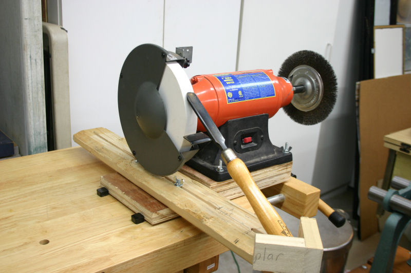

Longer style chisel (loaner scraper chisel from SDSSmith) no worry Rob....I won't sharpen the scraper with this set up. Only using it to demonstrate it's length :p
[ATTACH]10719[/ATTACH]
