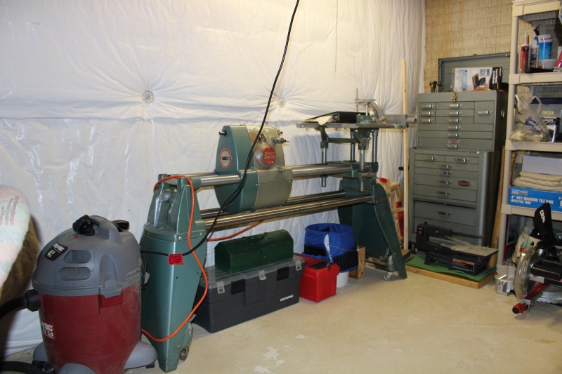

Pulled my other new toy out tonight and shot a picture of her. Next to it you can see the Craftsman toolbox I inherited from my wife's grandfather. Love the toolbox...they don't make 'em like that any more.
I've looked through some of the restoration photos in the forum and am pretty happy about the shape she is in. My Dad always maintained his tools well. I believe most of the chipped paint on the headstock was like that when he acquired it, as he was always pretty careful about taking good care of his toys.
After I get her checked out my first project is going to be to build a small workbench. I don't have a lot of space left in my corner and I want to get that miter saw and scroll saw off the floor. I'm going to put wheels on the workbench so I can slide everything out of the way when it's not in use.

wow. that really has been well cared for. it seems on my grays that there is always some rust on the inside of the legs when I got them. I think that it comes from where sawdust has clung and held moisture.

Yes that is one good looking greenie!

iclark wrote:wow. that really has been well cared for. it seems on my grays that there is always some rust on the inside of the legs when I got them. I think that it comes from where sawdust has clung and held moisture.
I second the motion.
That is in beautiful condition! You're dad did a great job!
