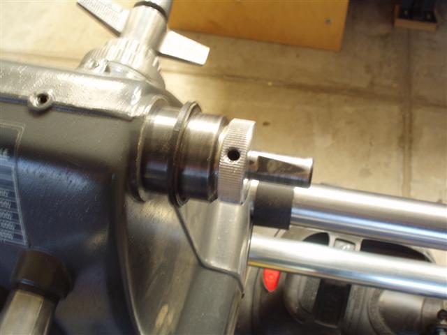

That having been said, I feel that it is necessary to make sure we are talking about the same thing. Is this the working end of what you have trouble with?
[ATTACH]11612[/ATTACH]
In that photo, take note of the set screw on the top on the headstock. That set screw may be covered with a soft lead or putty. If so, dig it out to gain access to the scet screw that secures the quill.
