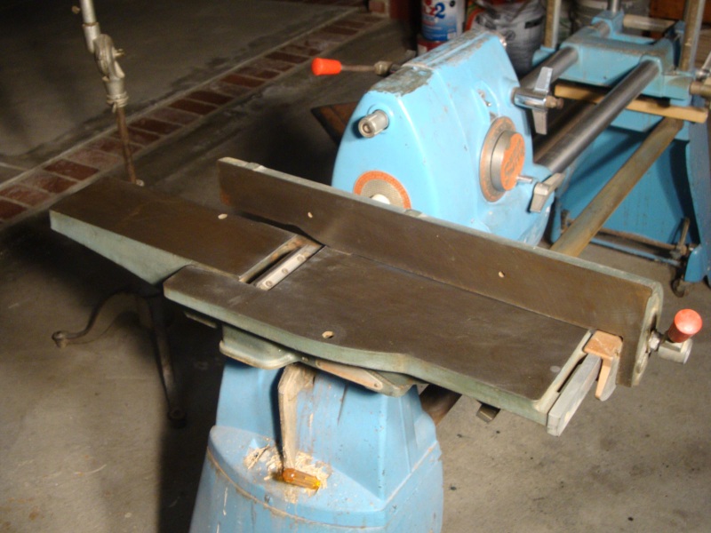

Here is a before photo Not in horrible shape but who wants rusty wood?
[ATTACH]11622[/ATTACH]

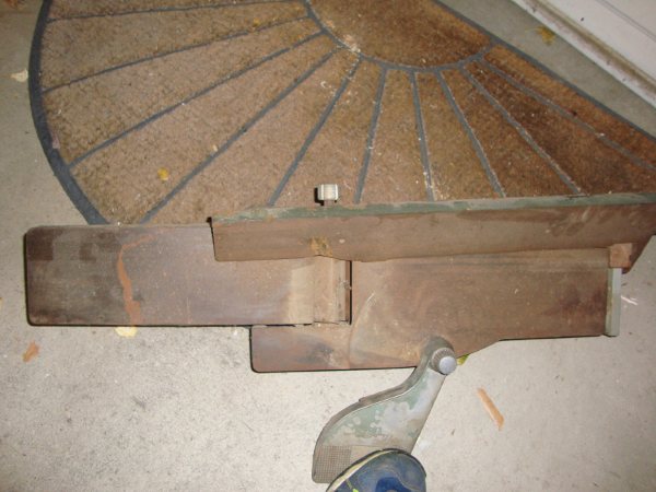

And Here are some pics after cleaning.
Removed the rust first with a green scotch brite pad for the loose stuff, then a baking soda paste and 400 wet sanding for the more stubborn stuff. I used a blow dryer on the cast iron to prevent flash rust. Finished with 2 coats of wax. I use minwax because that is what I have.
[ATTACH]11619[/ATTACH]

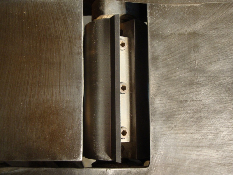

Here is the cutter head after cleaning. The entire cutter head was coated in a hard orange rust from many years of inactivity. I'm not sure my dad ever used this tool.
[ATTACH]11620[/ATTACH]
