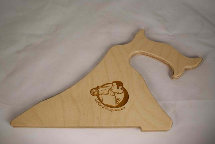

This is my vote for the best push stick design I found, simple, good hand clearance and holds down more than the back edge. It must be good plywood to avoid being weak at the top of the handle. I think I will just leave it attached at the bottom of the handle as well like most regular saw handles. I think it is a mistake to try to be too cute or classy on a piece of safety equipment. Forget being cute and put all of your thought into making it as safe as possible. Save cute for the projects. :)

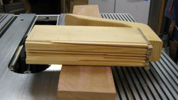

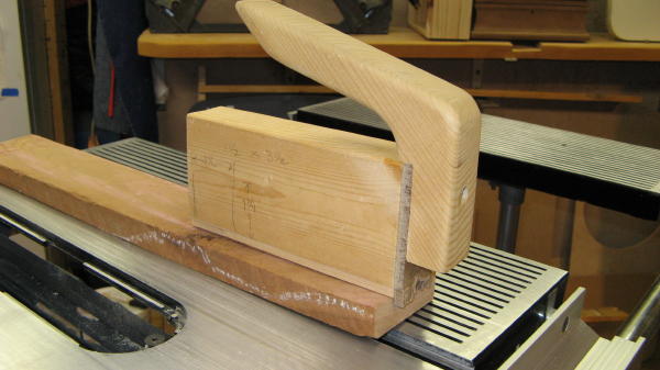

Here's my favorite. I think I got the idea from Woodsmith Magazine.
The 'shoe' can be longer as needed. The 'heel' can be longer or shorter to accommodate the currant need. I can make notes on it. And I just toss it in the fireplace when it's tired and make a new one. I always expected the handle to crack but it hasn't.
[ATTACH]11736[/ATTACH]
[ATTACH]11737[/ATTACH]
