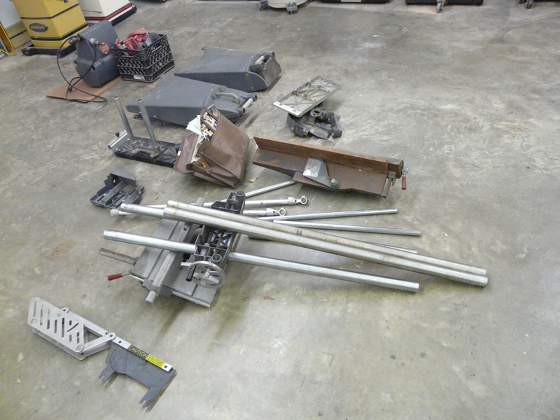

There is a Shopsmith hiding in there
[ATTACH]11660[/ATTACH]

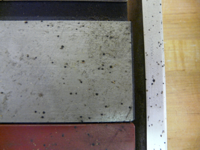

I believe this is weld splatter.
[ATTACH]11663[/ATTACH]
OK I cannot stand to have a tool that I am afraid to touch for the grime. I have a large vat that I can soak and clean all this in. Any recommendations for a cleaner that will not affect the aluminum?

I guess that I should explain that this came with both a mark 5 and a 520 table set up. I would be confused by the pictures in the previous post.

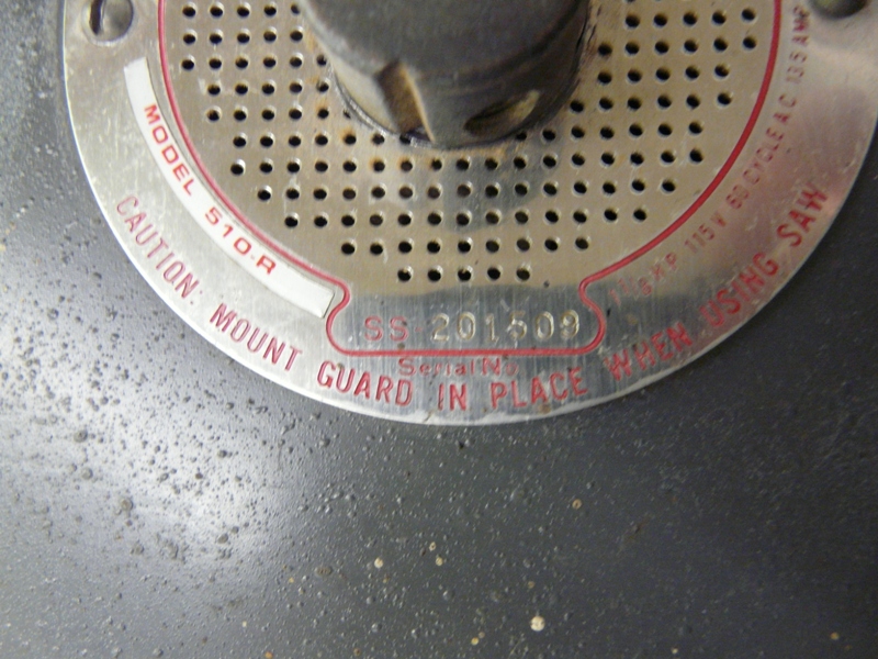

March-April 1985 Mark V/500 converted to 510(510R) then 520? Wonder where the rest of the 'leftovers' are?
Annnd the rest of the miter gauge?
