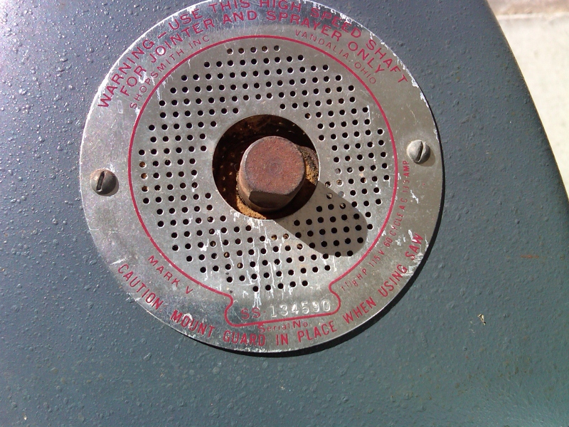

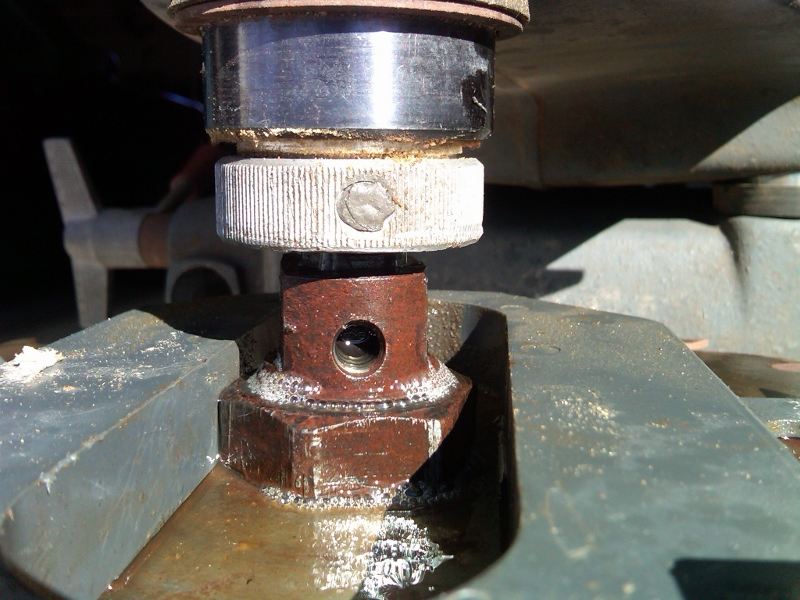

Hi All,
I was just given a Shopsmith by a friend. It is a Mark V. I am fairly certain it is the base model as there are no additional tables besides the primary saw table.
Anyway, the problem I am having is removing the quick change arbor from the spindle. I have removed the set screw, sprayed everything down with WD-40 but it will not budge.
Based on the self study course and the Shopsmith book that came with the saw it seems like it should just slide off.
I currently have the motor rails in the vertical position and some cushions under the spindle area in case it should decide to come free.
Any thoughts on what else I can do or should do?
Attached are some pictures for clarification.
- IMG00047-20110206-1508 (800x600).jpg (239.62 KiB) Viewed 2802 times
- IMG00048-20110206-1509 (800x600).jpg (347.21 KiB) Viewed 2793 times
- IMG00049-20110206-1509 (800x600).jpg (312.02 KiB) Viewed 2795 times
- IMG00050-20110206-1510 (800x600).jpg (395.88 KiB) Viewed 2790 times
Looks to have been made in 1982 for starters. Ya need to use some different penetrate. Like PB Blaster, kroil oil, etc. That arbor SHOULD just slide off with a POP. The tolerances are that tight. Does it move any on the spindle?
It appears that you have the arbor rusted to the spindle. You likely need some penetrating oil like Kroil, Liquid Wrench, or PB Blaster instead of the WD-40. Give the stuff some time to work (overnight or longer), keeping the Shopsmith in the vertical position. Some light taps with a small, soft hammer on the arbor might help.

I had to use a gear puller to get mine off. It was rusted just about like that. After it came off I cleaned it up with a brass brush and it worked great after that. The tolerances are so close that a tiny bit of rust locks it right up

Used PJ and borrowed a jaw type puller from Napa
Man, was that ever seized on!. Had to keep using the wrench on the bolt until it was completely removed. Never would have come off with just the rust buster.
