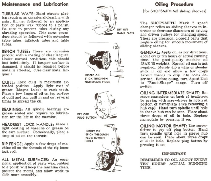

Instructions for cleaning and inspection. Here's images of the holes in the shafts you want to make sure to lubricate.
Here's instructions on replacing the belts. Sounds like it just needs to be cleaned out and lubed up. Just use 3-in-1, Kroil, or turbine oil. Your bearings should be good, just listen to how well they turn once you get the headstock broken down. If it's been sitting in a barn, check the wiring for dry rotting.

Maintenance and Lubrication
One more piece of info: here is the maintenance chart from an older manual, also available on the wiki.
