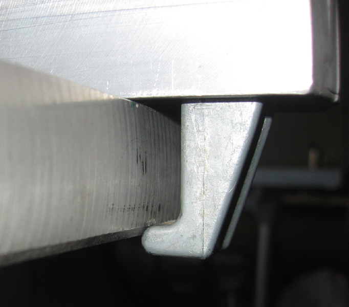

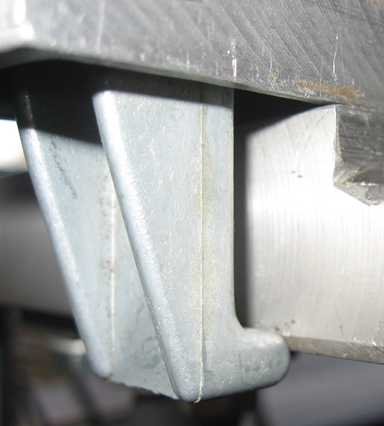

I've had my Dad's "greenie" for about 15 years and decided to buy a newer version (1980+) off eBay. The machine is in great shape, but when I looked carefully at the rip fence I noticed that it didn't clamp over the back edge of the table because the table appear to be too thick. I tried my old rip fence with the same result--and they both clamp fine on the old table. Did Shopsmith change the thickness of the tables slightly on some model years (it appears to be about 1/8")?

Pictures
Hi,
Thanks for all the replies to my question. I've only used one Shopsmith before (for about 50 years), but the new one I bought looks the same (including the table). I'm not sure if my pictures will show up--I don't see them in the preview.
Thanks, Jim
Thanks, Jim
- IMG_1725.JPG (93.75 KiB) Viewed 2339 times
- IMG_1726.JPG (92.91 KiB) Viewed 2339 times
jemcdon wrote:Hi,
Thanks, Jim
The pix are fine.
Now tell us 'what is what'?
You indicated you had 'differences' between old/new.
Both pix are 'normal'. That is the way it clamps.
The way it clamps?
Wow! Then there's something wrong with the old table (that my Dad and I used for 50+ years), because the clamp goes completely over the table on the old Shopsmith. If this is the way its supposed to be I guess I'm content...
Thanks, Jim
