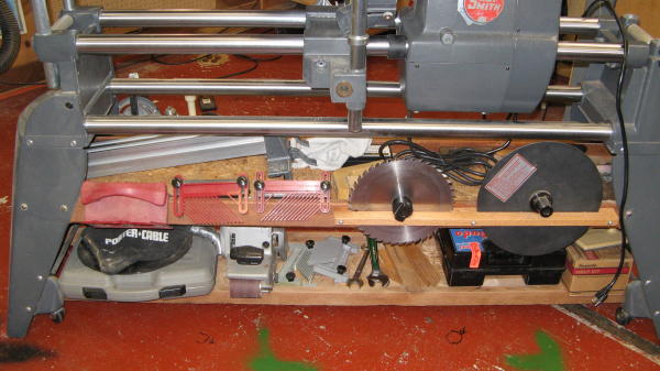

I think everyone who has a SS has they're own idea of what constitutes efficient storage under the the unit. Here's what I did. No plans, sorry. The lower shelf actually rests/rides on the 'axle' for the casters.
[ATTACH]13341[/ATTACH]

How the heck do you raise and lower the casters?

With the standard "OEM" shelf, there is plenty of room. But with the double shelf mentioned above, that is a very good question.
