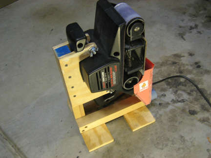

Something like this?[ATTACH]12747[/ATTACH]Gene Howe wrote:Good morning.

- Belt-Sander-Stand.jpg (29.41 KiB) Viewed 2871 times

I am curious about what advantage there is to using something like that? What function does it play?

It prevents the gouging that often occurs and it's helpful in leveling edge glue joints.

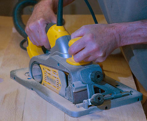

The article here http://www.finehomebuilding.com/how-to/use-a-belt-sander-frame.aspxsanding frame, (page 2, then click "Read More") shows an adjustment knob on the frame. The author says it can be adjusted from 1/32 to 1/8. The frame discussed in the article MAY be a Dewalt item. If so, I may have to devise one to fit my PC. PC doesn't make one.
I plan several future projects involving edge/edge and subsequent face/face glue ups, finished size wider than my planer. Though I use the jointer, planer and cauls, There is often some misalignment. Infuriating!! I'm no good with a hand plane (though I'm practicing!)
In the past, I've used the beltsander, then on to the "V" sander to achieve the extreme flatness I need for the face to face glue ups.The "V" sander does a great job, but it's a very long process (many passes) to eliminate the slight irregularities left by the belt sander. My production run is usually 64 each of four 17 1/2 X 17 1/2 X 3/4 edge glued panels. Each of which need to be dead flat on both sides. That's 512 sides to be flattened!!!! A cardiovascular workout, for sure.
So, you can see I need every little bit of help I can get. The frame would, hopefully, eliminate some of the passes on the "V" sander.
I may just resign myself to building a planer set up for the router. I've been avoiding that as I don't want to spend the time building that jig.
