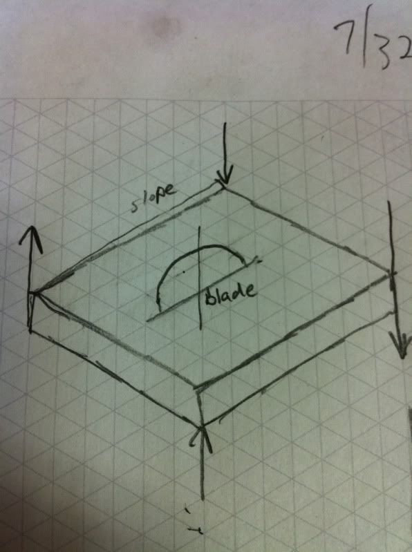

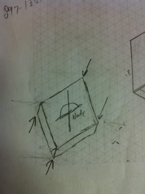

So, the table is square with the blade.
But, not with the earth. No imagine the direction of slope as an arrow. With the table at 0 deg, the direction of slope does not intersect the blades vertical plane. Table is true in relation to blade.
However, when the table is tilted on the axis of the slope (side to side in this case) then the direction of the slope opposes the vertical position of
The blade. The table is no longer true to the blade.

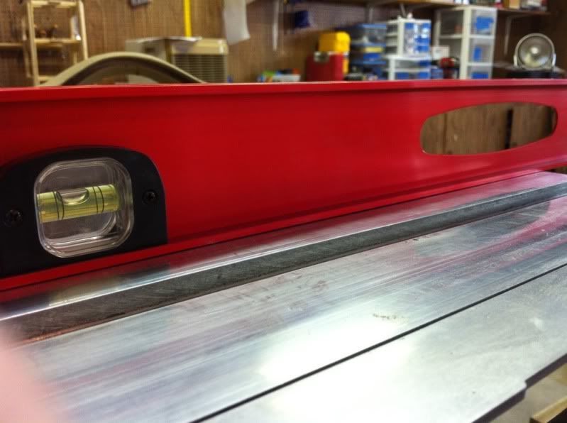

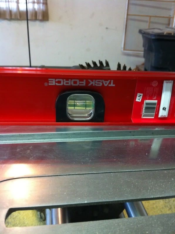

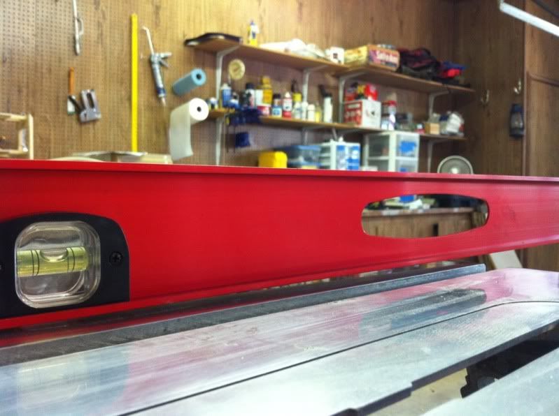

But I believe I have leveled the table, I will have to see.

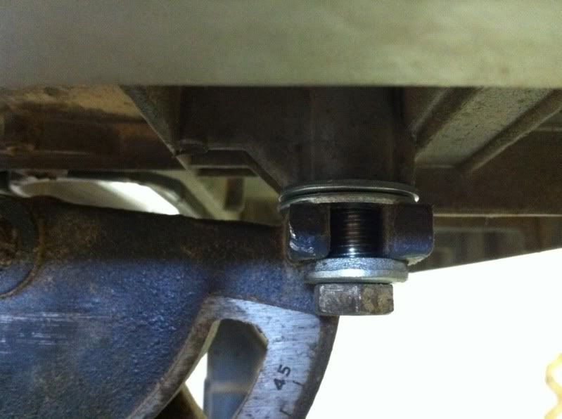

Thank you for that answer(not a compound angle cut!).gat_76 wrote:Oh, and I had table tilted, clamped in miter gauge. 0deg (90deg cut)
We need to distinguish between flat and level.
Yes the table needs to be flat, and shimming the mounting bolts will accomplish that(assuming no warping). Being flat is not the same as level. When you 'tilt' the table with the trunion, it is not level, but is sill flat.
A 'level' table is square to the blade(vertically) only if the blade is vertical(plumb).
The second square to the blade requirement is totally independent of all that above. It is also the likely cause(lack of it) that is causing your binding.
