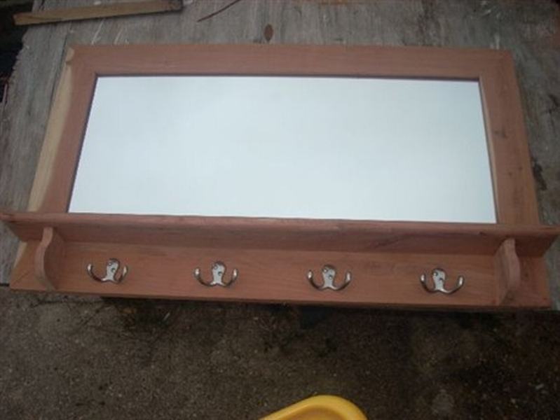

These were molded with the SS table saw and mitred with a Delta Shopmaster. These were built with 1/32" tolerance. When you take these to the glass shop, you don't have much room for shifting, so they have to be close.
http://www.handymanclub.com/forums/aft/46326 Another frame that had to be close tolerances for the mirror. The glass cutter wouldn't even consider anything other than a 90 degree angle on this frame. So, it had to fit almost perfectly. For those of you who have experience with Shopsmith's, I did this with the thought that many who are unexperienced with a SS don't think you can build things with this close tolerance. I may have to do this to share my work.

HMC pix.................................................................................................................................................SS Forum pix
- mirror with hooks.jpg (26.31 KiB) Viewed 2546 times
- mirror with hooks 2.jpg (35.89 KiB) Viewed 2547 times

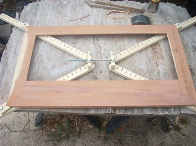

Picture Frame Clamps
I really like your jig gator. I hope you don't mind if I make my own copy based on your image from that other site.

Thanks for the compliments, Dusty. Saw one advertised in Rockler and decided I could make something similar. So, here is the thread on how to make it. I did letter each hole so when I need to make an adjustment, I can put the little block in the right letter hole on each leg. My cost in materials was about $10. Looking forward to seeing your finished product.

Thanks, JPG. The three programs that I have will only reduce to 640 X 480 which is too large to attach here. The mirror was made from rough sawed cedar of a tree that grew in the front yard of my wife's family. All the picture frames were made of the rough sawn cedar. Used the sanding disk to make it all the same thickness -- long and boring--but consistent. Then used the table saw to make the shapes, mitered by compound mitre saw.
Using the framing jig can be a PITA sometimes. I have better success with larger frames.
