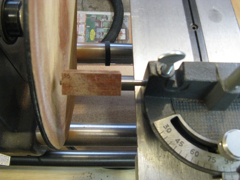

I use something similar, a shaft through the stop rod holes of the miter gauge. I find it is easy to align the shaft to the disk by tilting the table and turning the miter gauge as the holes in the casting are not true to the face of the gauge.
For the larger tube size I use a sleeve that was designed for use with a barrel trimmer.
[ATTACH]13402[/ATTACH]
sanding blanks.JPG (206.98 KiB) Viewed 1333 times

Very innovative, farley! I would suggest, however, that you elongate the block that you have clamped to the miter gauge. This would enlongate the area that is holding the shaft and I believe make it more stable while sanding. Good Job!
MikeG wrote:I use something similar, a shaft through the stop rod holes of the miter gauge. I find it is easy to align the shaft to the disk by tilting the table and turning the miter gauge as the holes in the casting are not true to the face of the gauge.
Equally innovative, mike. This is just another example of the versatility of a standard Mark V. It (and you) are truly versatile.
