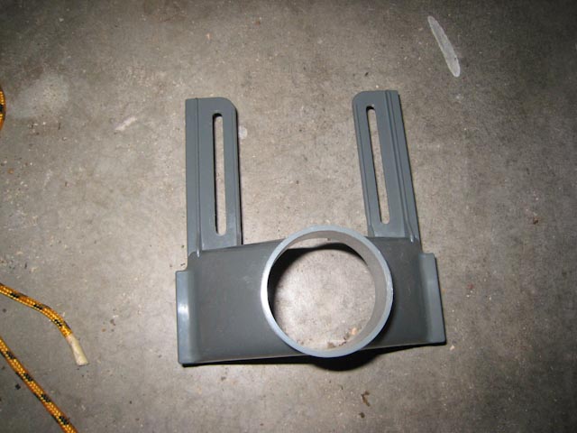

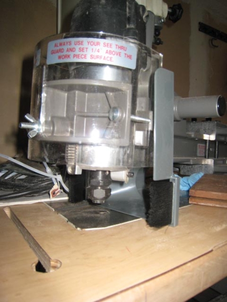

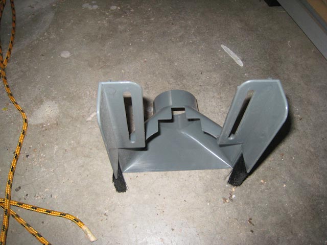

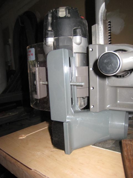

Here is the photos of the dust shield that comes with OPRs (this is from my new one, and the old one had the same thing).Gene Howe wrote:Thanks for your reply. It dropped off the "New Posts" section before I got to see it. I just this morning found it.
I'd surely be interested in any photos or ideas you could provide. Mine didn't come with any sheild or DC capabilities. I can't see where it could even be attached near the router.
I sent you an email, too. Please feel free to use the forum for a reply, or via email. whichever is most convenient for you. And thanks a lot for your time.
[ATTACH]13450[/ATTACH]
[ATTACH]13451[/ATTACH]
[ATTACH]13452[/ATTACH]
[ATTACH]13453[/ATTACH]
- OPR Dust shield (1).jpg (145.53 KiB) Viewed 2323 times
- OPR Dust shield (2).jpg (74.03 KiB) Viewed 2318 times
- OPR Dust shield (3).jpg (77.02 KiB) Viewed 2314 times
- OPR Dust shield (4).jpg (160.98 KiB) Viewed 2317 times

I suspect that the assembly number (515146) may have changed with the new OPR. The individual parts of the assembly (dust chute, brushes, etc.) show up online.Gene Howe wrote:Thanks Rob and damagi!
I'll be ordering the assy.
The number listed on the parts breakdown (515146) doesn't seem to work, so I emailed SS direct.
Like professional sports teams, you can't tell the players without a program. Shopsmith parts numbers change and you can't tell what's what without a manual.]
Rob in San Diego
Gene,
I would just get the chute and the brushes. The wire hanger and the short section of hose are a PITA, however, you do need to support the hose so it doesn't put too much stress on the tabs of the plastic chute. I strap the hose to the support arm with a velcro strap.
