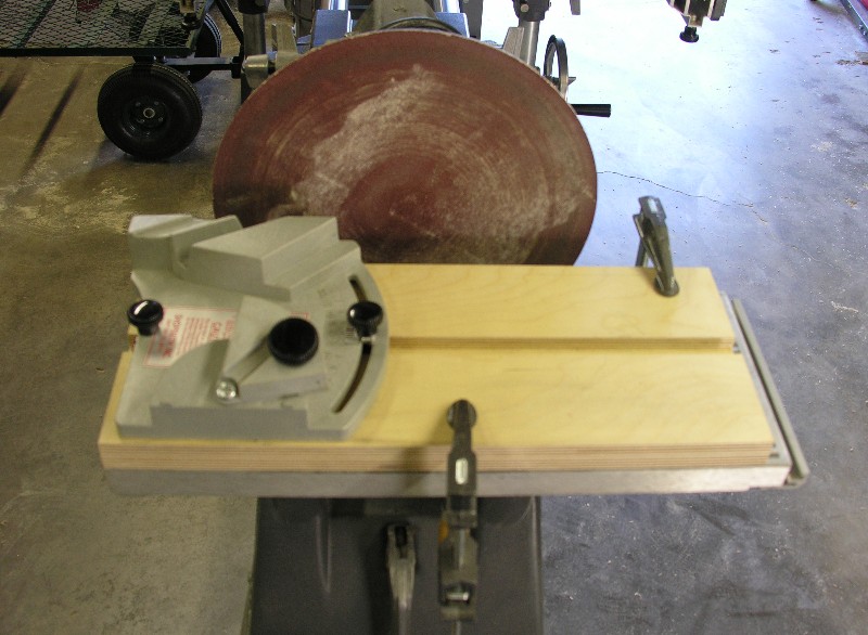

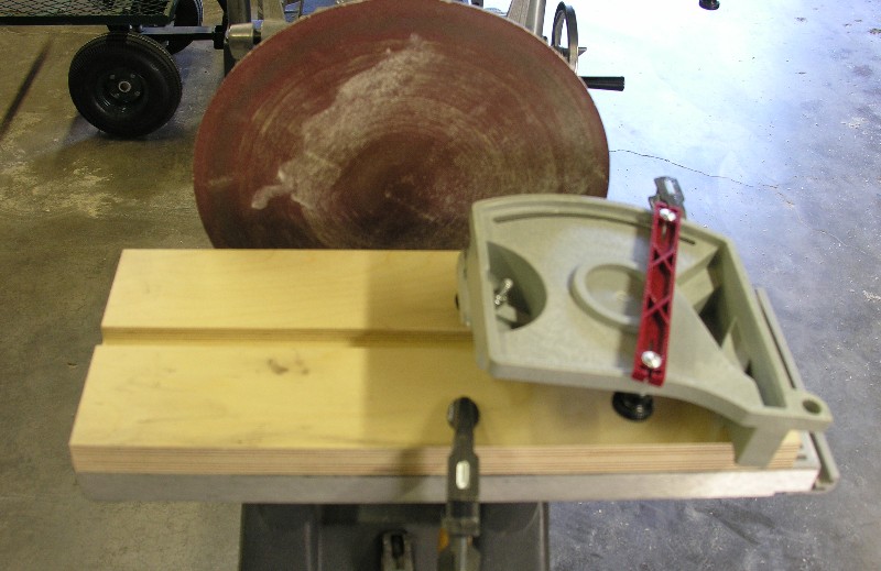

Dusty,
This is the simple jig I use to avoid drilling holes in my extension table.
ldh
[ATTACH]13463[/ATTACH]
[ATTACH]13464[/ATTACH]
