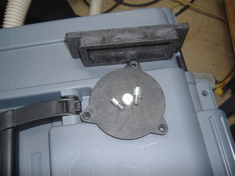

Will someone please post a photo of the Spacer Block (Ref part 83, 515513) and 1/4", 1/2" and 3/8" Pins (ref parts 46,47,48, 515499,515500,515502)? I don't know what these parts look like.
I haven't used my Routing System (555413) overarm and under table, with router table upgrade for years.
Requested photo
[ATTACH]13703[/ATTACH]

Post by wgander »
Thank you.
The pins are probably in a box with all of my router bits. I don't remember seeing anything like the spacer; I'll have to look again and probably order one. Without it, the overarm holder, safety shield and dust collector aren't very secure.

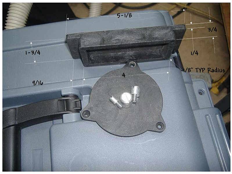

Hi,
If you want I can add some dimensions and you can just make one out of wood. It is not a critical sized piece and they may not carry it anymore anyway.

Ed, thanks: please post or email (wgander1@comcast.net) the dimensions for me.
Bill
Hi,
Looks like maybe some 1/2" plywood/MDF for the bottom part then glue on a 1/4" part of like material and spray black should do it.
[ATTACH]13738[/ATTACH]

Thank you...

Nice job of marking the photo with dimensions and arrows............what program did you use, please?
Peter
Thanks.
The program is Micrografx Designer which is no longer around, sadly.
