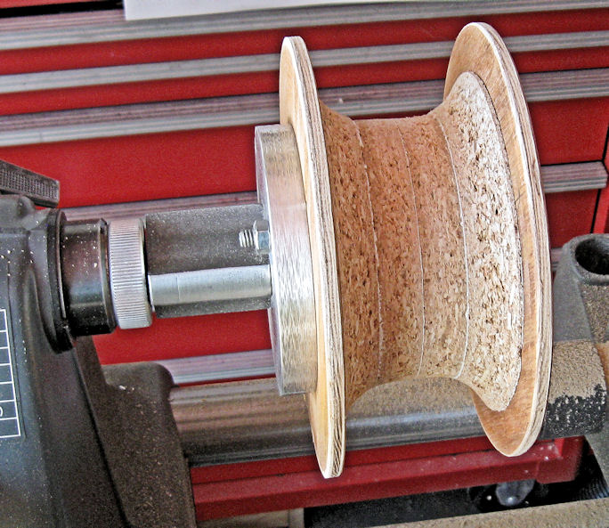

It uses standard 3x21 sanding belts and a 2.80/2.50-4.00 lawn mower inner tube, quite clever of Mr. Gregg I think. I used a 5/8" center hole instead of his 1/2"; 5/8" MDF, so four layers instead of his five; and 1-7/8" dia. valve access holes. I am about to turn the inner tube seat in this photo:
[ATTACH]13758[/ATTACH]
After turning it looked like this:
[ATTACH]13759[/ATTACH]

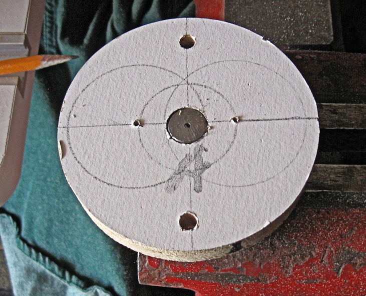

I used a piece of 5/8" shaft to keep things lined up and for marking out:
[ATTACH]13760[/ATTACH]

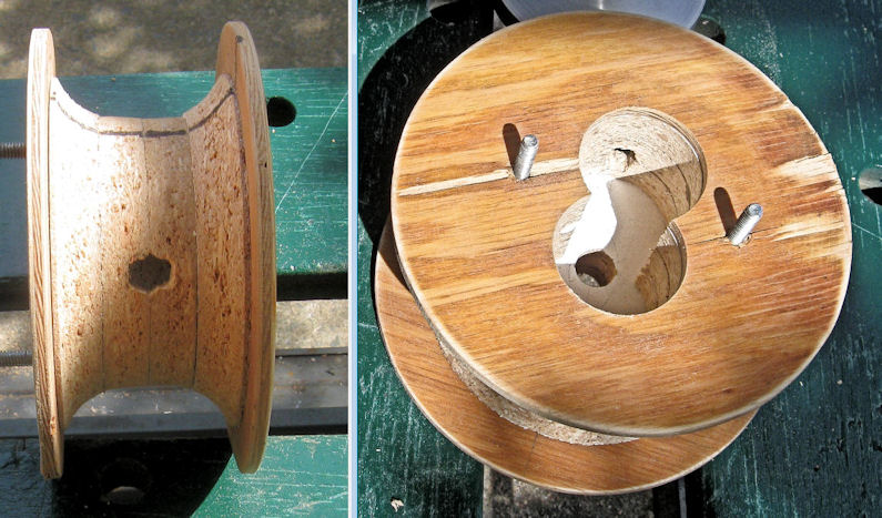

Here it is ready for the inner tube:
[ATTACH]13761[/ATTACH]

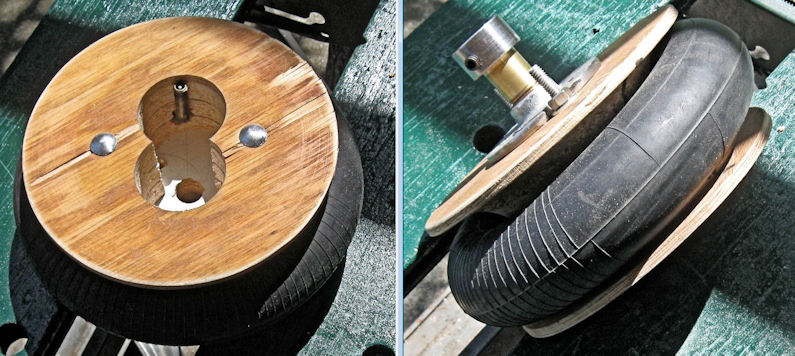

You should hole saw the inner tube valve access holes last in the sequence of assembly steps, to keep the 5/8" center hole till no longer needed for centering. Here is the inner tube, bought at a local riding mower repair shop, installed. You can see the fill valve in the access hole:
[ATTACH]13762[/ATTACH]

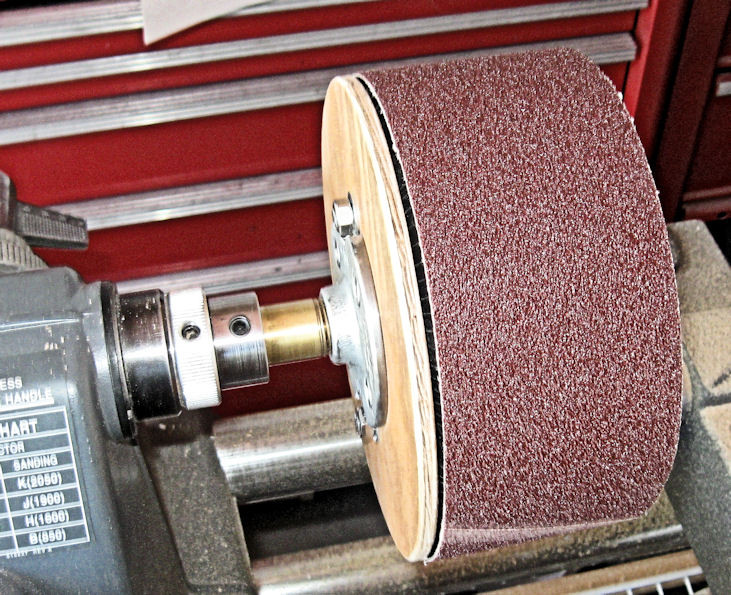

I cut off the protruding 1/4" bolts and screwed the floor flange based faceplate to it. I preferred to mount it on the same one it was turned on, but managed somehow to hole saw the inner tube valve access holes in the wrong half of the pieces, and the 1/4" bolts would not fit through the two holes in that faceplate, due to not drilling exactly perpendicular, so I used the floor flange one. All is ok in the end. It revolves reasonably smoothly and works fine as a sanding drum. I did not center the belt well for the photo below:
[ATTACH]13763[/ATTACH]
I may cut the 1/4" plywood rims down some; they barely fit inside the 3x21 belt!
