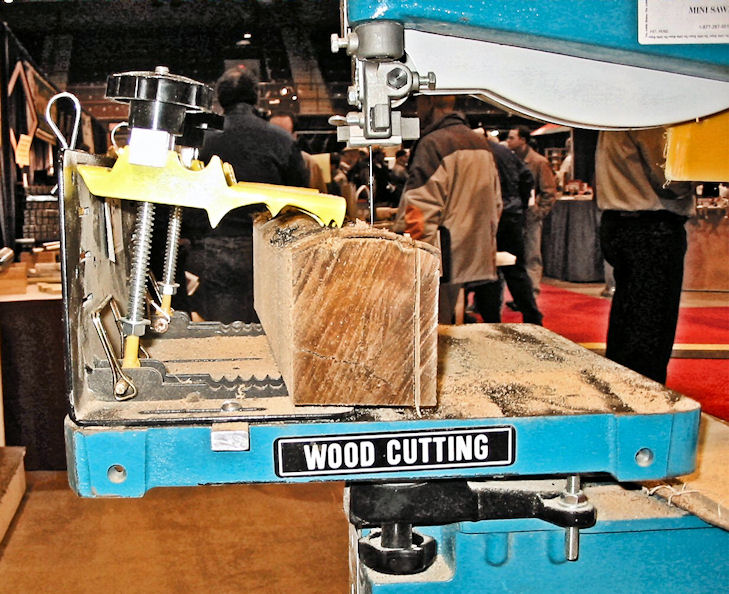

Here is a picture of a commercial one for logs seen at a wood show:
[ATTACH]13901[/ATTACH]
bandsaw resaw logs.jpg (149 KiB) Viewed 4922 times
