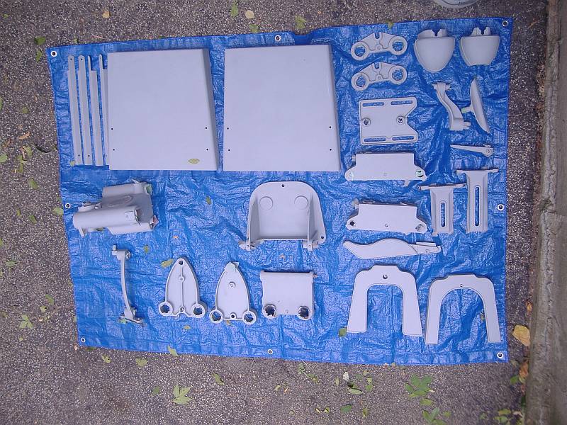

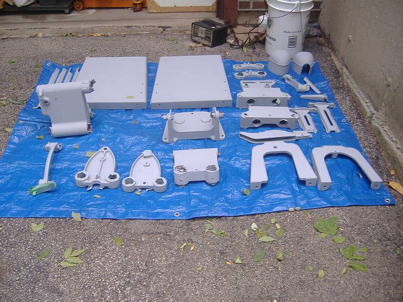

[ATTACH]14304[/ATTACH]
[ATTACH]14305[/ATTACH]
These are the primed and ready to shoot pieces for that other day. Not pictured are the tubes, done last summer, and a lot of smaller parts that are cleaned up but don't get painted.
The main table top, not pictured, looks nasty as does the lumber for the bench. Hope to work them in during the rains they claim are coming for the next few days if I can.

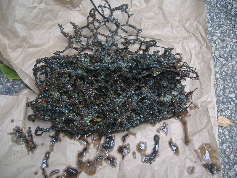

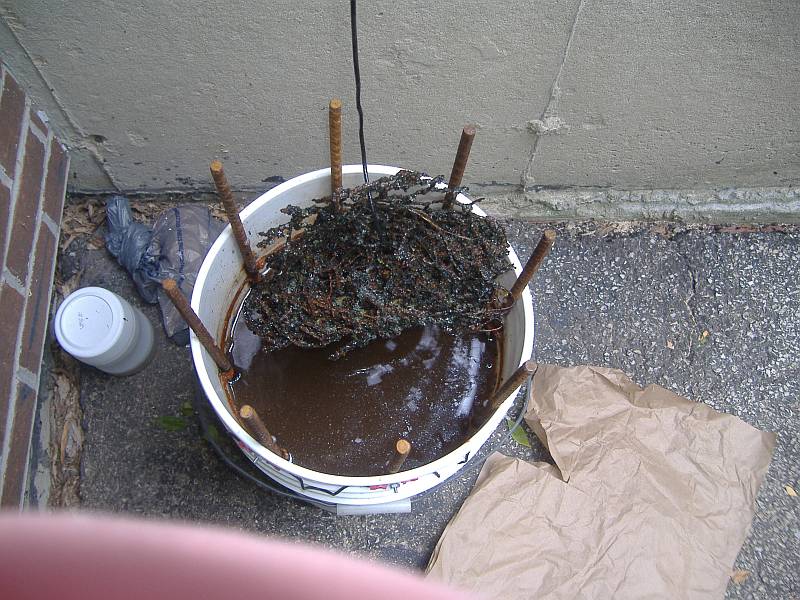

Speaking of nasty, I cleaned up the tank today, some rusty chicken wire and reverse the leads leads to this:
[ATTACH]14306[/ATTACH]
[ATTACH]14307[/ATTACH]
I leave the wire dry out for a couple of days then step on it and most of the gunk is left on the paper, this is the 5th time this wire has been used.

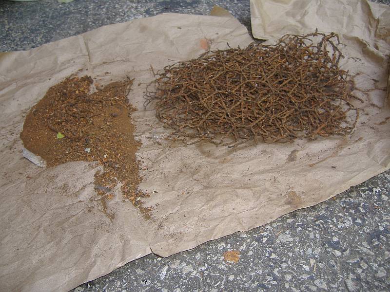

Remember the chicken wire with all the mess from the earlier post? If not go back and check that, then take a look at the "after it dries and I step on it" photo here:
[ATTACH]14377[/ATTACH]

Tank cleaning, the bits that come off the rusty item you put in collect at the other metal in the tank. If you reverse the connections it happens the other way round and the chicken wire collects the junk and you can then get it out of the tank.Shop_Smith_Poppi wrote:and what is the purpose of this chicken wire?
