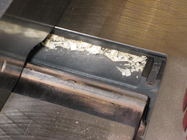

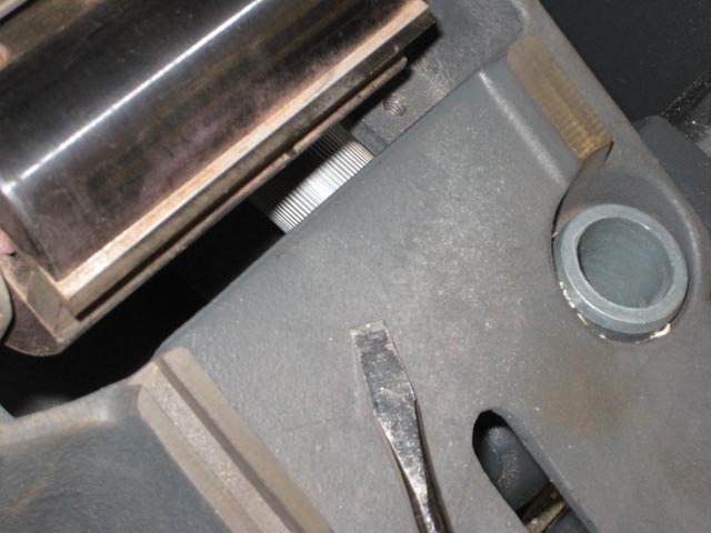

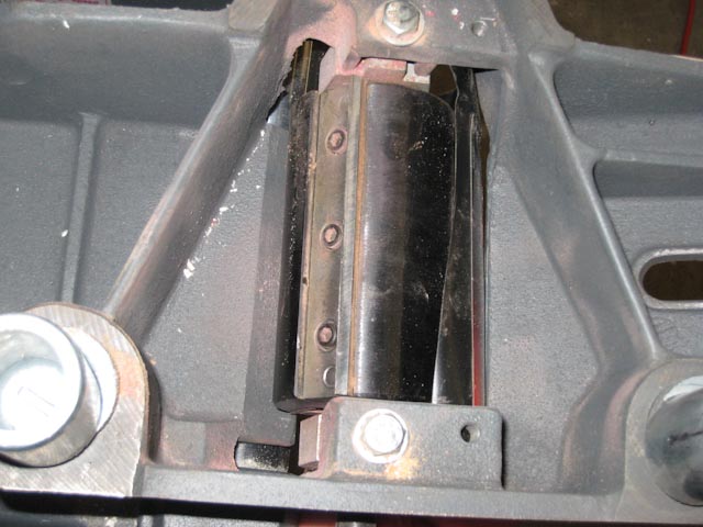

Just curious if anyone has done work to improve the dust collection on the jointer. I have the SS supplied dust chute and it seems to get plugged up pretty quick.
Here is a shot of the standard jointer with the dust collector chute removed
[ATTACH]14472[/ATTACH]
The shavings seem to accumulate on the right side of the cutter-head and then pack up into other parts of the casting.

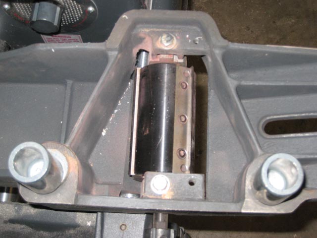

Proposal is to use some plastic to add a deflector, which would hopefully prevent stacking of chips. In doing so the hope would be that the chips would be better directed down and out the chute.
[ATTACH]14473[/ATTACH]
[ATTACH]14474[/ATTACH]
Thoughts? Anyone try something similar? I saw http://www.shopsmith.net/forums/showthr ... +collector, but it seemed like that design on its surface would be subject to similar issues.

Wish ya wood of had a pic when it's plugged up. Mine doesn't do that. Collection is MUCH better after I let the area under the infeed fill up.
Yeah, I was thinking the same thing. However, naturally the fact that its better once its plugged up is exactly why I am interested in adding deflection.beeg wrote:Wish ya wood of had a pic when it's plugged up. Mine doesn't do that. Collection is MUCH better after I let the area under the infeed fill up.

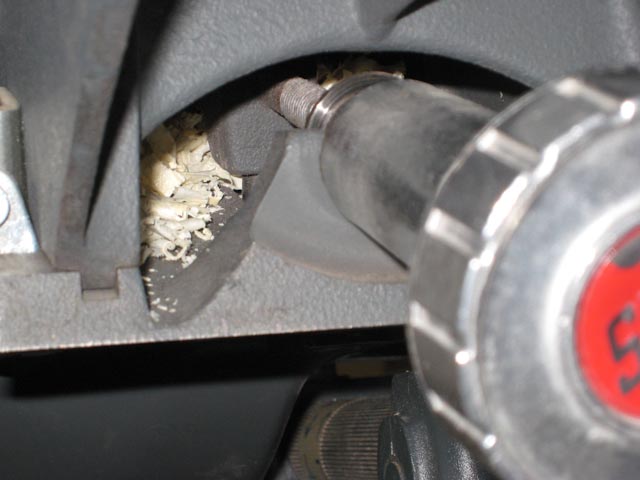

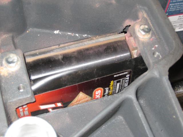

Here are some photos after running a piece of pine through a few passes:
[ATTACH]14486[/ATTACH]
[ATTACH]14487[/ATTACH]
[ATTACH]14488[/ATTACH]

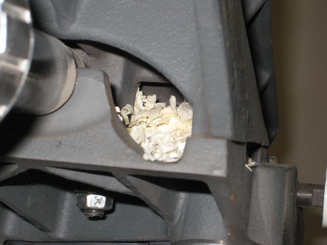

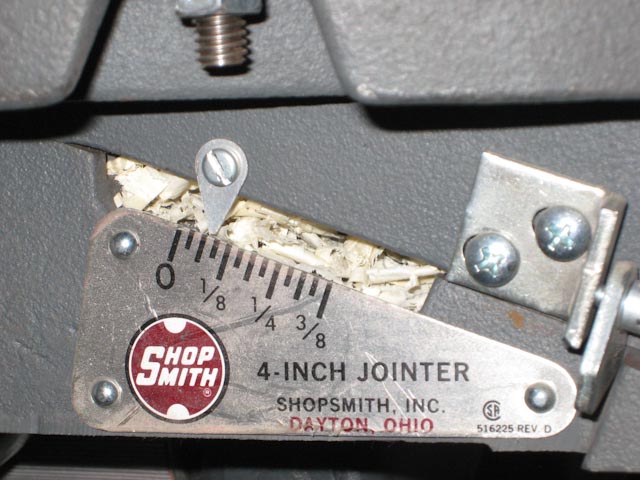

I did some investigation and I think I found the culprit. In the main casting there are two ridges upon which the infeed table slides. It appears that regardless of whether or not the dust chute is attached, chips still seem to go out that direction.
[ATTACH]14489[/ATTACH]
[ATTACH]14490[/ATTACH]
Taking a page out of dusty's book, I took some video of the jointer with the dust chute on and off. Obviously, the dust collection hose improved everything that otherwise comes out the bottom of the jointer. However, in both videos you get the chips being shot back towards the front of the unit by going through the area I described above. I think with some plastic, foam, or similar I can seal off the offending region without any loss of performance. I will play around and see what happens.

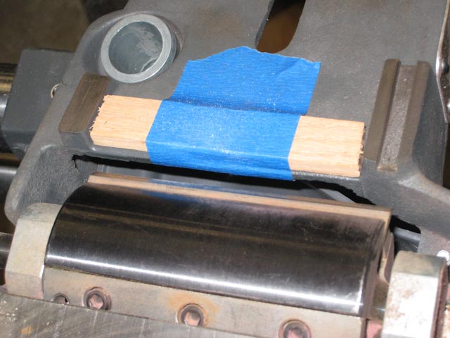

Success!!
Mystery solved - my hypothesis proved correct. I temporarily taped in a 1/4" thick x 3 3/4" long piece of scrap that I had. Doing so eliminated all* of the chips from the area in question.
[ATTACH]14491[/ATTACH]
As can be seen, this works quite well. I haven't done exact fitting or anything, but the 1/4" stock I had seemed to fill the gap without impeeding the movement of the infeed table. Moving forward, I will probably tack the piece down with carpet tape. I might consider swapping out for a piece of acrylic just for piece of mind/no wood movement/etc...probably not necessary
*by all, I mean that it didn't get filled with chips. I didn't see any after running a bunch of passes, but I could be missing a few. In reviewing video - as long as I am feeding the stock through at a reasonable rate it seems to catch everything.

If you use the above modification then the will be no chips going into the area underneath the infeed section. Based on that, the standard dust chute achieves ~99% collection.
