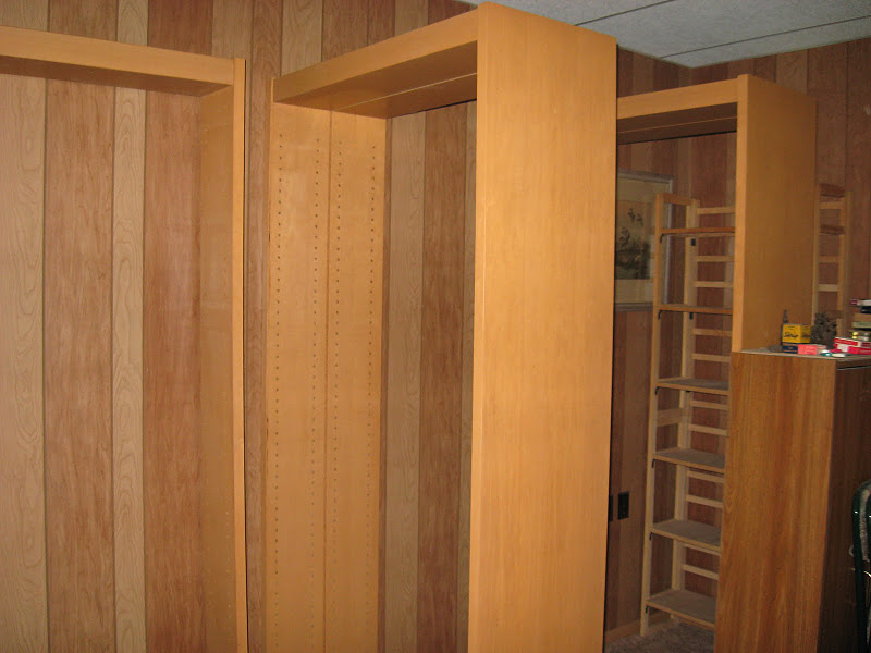

Here is a picture of 2 of the stacks with all of the books and shelves removed. On the left is half of one I cut in half. It is just sitting there not attached to the wall yet. The library is in a part of the house that is about 175 years old and I will have to do a bit of shimming at the floor to get the shelves to sit exactly level.

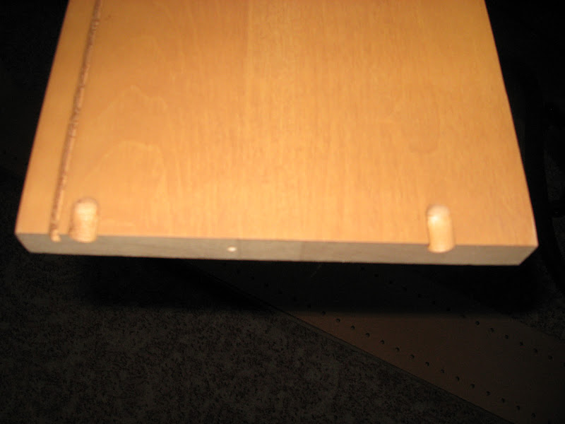

Here is the groove detail of the underside of the shelves where it sits on the "All-thread" pins.

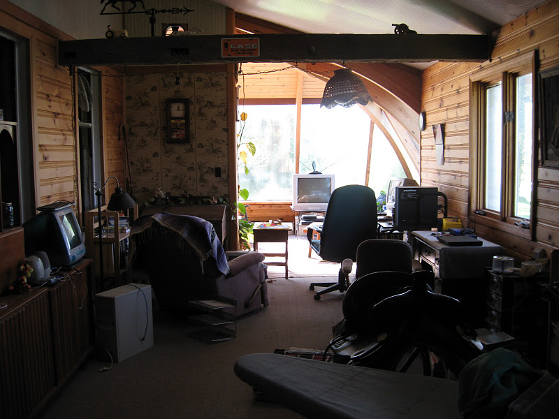

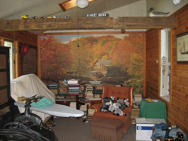

Here is a shot of the area that will become roughly 12'X12' den (a bit piled up at the moment). The old window at the right will become the door opening from the library.
[ATTACH]14494[/ATTACH]
This is a shot from the den area the other direction toward the solar room. The wall between this area and the den is planned to be back to back shelves with book shelves on the den side and display shelves on the other side. There may be a glass window with mini-blinds or shutters in that wall.

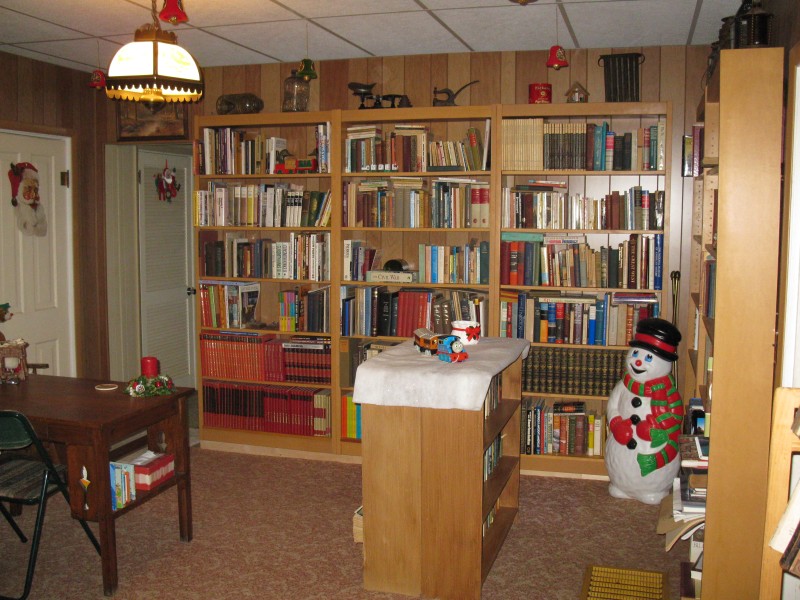

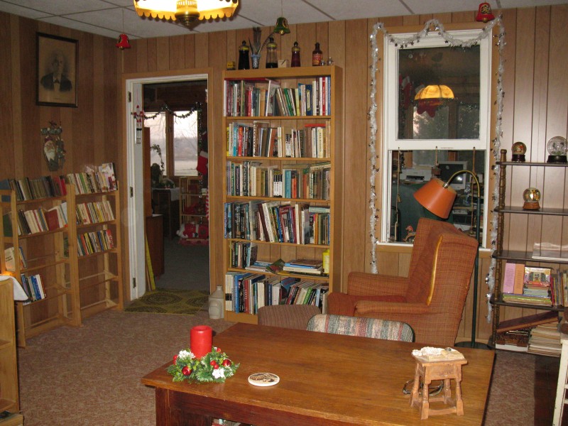

Here are a couple of follow up pictures of the library project showing that I did get the books back on the shelves after cutting those stack units in half. I still have a lot more to do there but stopped for the holiday season. I still have what would make a large pickup truck load of books in storage that I need to creat a home for. Beyond that window in the second picture is the den and I have several sets of smaller book shelves full there.
[ATTACH]15708[/ATTACH]
[ATTACH]15709[/ATTACH]
