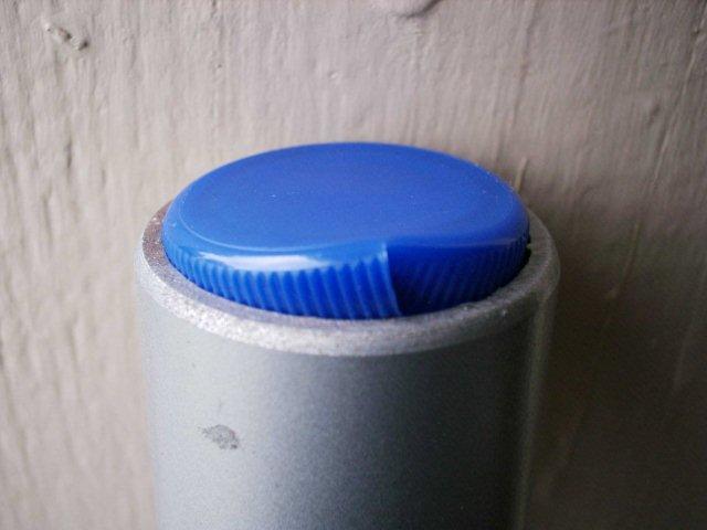

I can't think of any good coming from packed sawdust in the Bench and Way Tubes that had accumulated in the current rehab project. It was packed too hard to be cleared by shop vac and seemed like a clog of 4 - 6" length. Fortunately, this MK 5 was in a dry garage.
I thought that a one gallon milk bottle cap would fit in the tube. No joy. By cutting slits in the side of the bottle cap, it would fit.
# slits ----- Reward

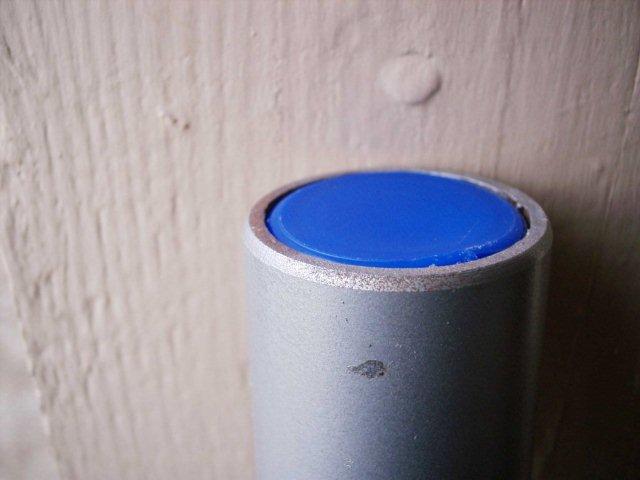

Only suggestion is to avoid cutting into the top, cut slit in the side of the bottle cap only. [ATTACH]14516[/ATTACH]
Bottle Cap w/ one of three slits.
[ATTACH]14517[/ATTACH]
Inserted Bottle Cap. Tube was set on floor to seat it evenly.
Caps used are marked "PORTOLA 358-CP05-68" , inside the cap.
Light Duty Plug for Mk 5/V Tubes
