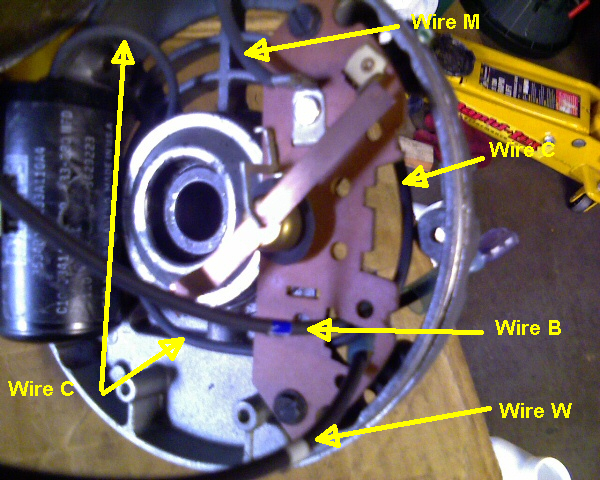

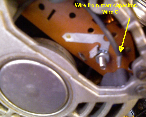

OK, I did forget the camera so I only have crappy phone photos.
Got back tonight and a few parts I had ordered from Shopsmith had arrived. The power switch had 2 black pigtails that was correct but only one white one and that had 2 male connectors. Is that typical?
So the photo above shows a larger spade connector and that is the one that is causing me problems, what the heck goes to it?
Does it take a white direct from the power cord or via the switch? Is it used at all?
Any help on what wire goes where appreciated.

Well you surprised me with those pix. The previous comments made by me were relevant to a different emerson vintage.
Your pix do match one that I had thought was damaged(terminal missing).
So tomorrow I will take a look at that motor(still disassembled) and get back to you.
I believe the answer will be that the .187 terminals are correct(one on each side of the terminal board), and the pigtailed leads are the power leads.
Let me verify that before you connect anything!
Re the switch, the white pair seems reasonable. The two black 'pigtails' also seems reasonable. I am not real familiar with the newer power cord wiring, so a pix of that and the switch would help me. From your description of the switch, I would expect a white marked wire from the motor and the white wire from the power cord should connect to the white wire male connectors. The blue marked motor lead would connect to one of the black switch 'pigtails' and the black power cord wire to the other black switch 'pigtail'. I assume the 'pigtails' are female or one each(male/female).
To be sure, I need to see the switch leads and the 'pigtails' and both motor pigtails.
I need some info from you.
How many wires are coming out of the motor windings?
Is a wire from the motor windings connected to the terminal on the capacitor that is NOT connected to the terminal board(outside). [Wire C]
Are wires W and B coming from the motor windings?
Does wire M come from the motor windings?
[ATTACH]14619[/ATTACH]
[ATTACH]14620[/ATTACH]
Do you have an ohmeter that can tell the difference between about 5 ohms and about 0.5 ohms?
