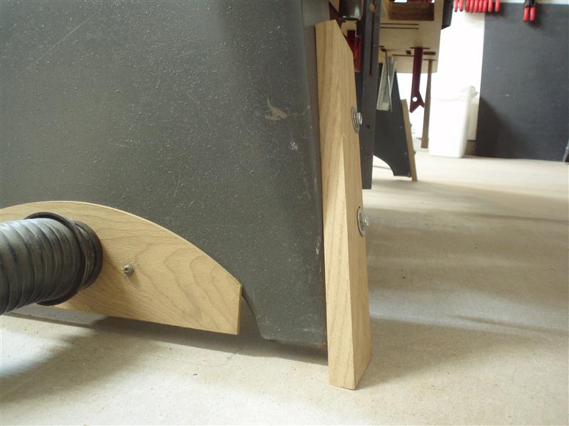

Stabilizers to Compensate for Uneven Floors
I have stabilized my Mark V despite the floor where I now have the Shopsmith located. The stabilizers are NOT elegant but they are functional. They also serve to compensate for the fact that the floor slopes about 3/4" over the length of the floor (provides drainage when the snow off the car melts:rolleyes:).
The bottom of each stabilizer is mitered and then beveled to match the Mark V legs.
I made one of the mounting holes a slot so that the stabilizer is adjustable. The other mounting hole was drilled after the stabilizer was in place. This means that the stabilizers may not work without modification if the Mark V is moved very far.
I do not routinely relocate the Mark V and do not have casters installed so this method, while not elegant, works fine.
[ATTACH]14634[/ATTACH]
[ATTACH]14635[/ATTACH]
After stabilizing the Mark V a quick check of table alignment reveals that "it is still properly aligned".
[ATTACH]14636[/ATTACH]
- Mark V Stabilizers 001 (Custom).JPG (60.68 KiB) Viewed 1741 times
- Mark V Stabilizers 002 (Custom).JPG (59.32 KiB) Viewed 1740 times
- Mark V Stabilizers 003 (Custom) (2).JPG (83.15 KiB) Viewed 1741 times

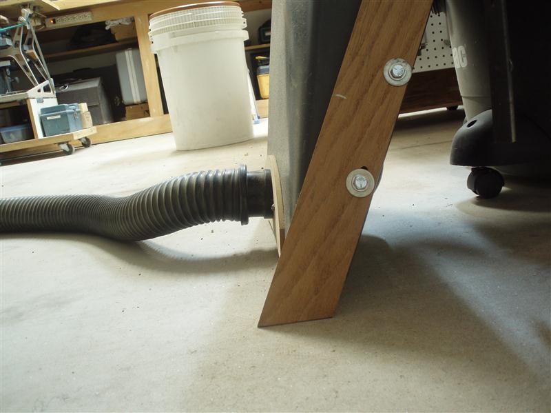

DC hose attached to leg of MV

I think that you might be asking about the dust collector hose? If not, I don't know what to say.JPG40504 wrote:Do tell us about 'the tail'!
The dust collector hose is about 8' long and connects where you see it with the other end connector to the DC3300. On the inside of what you see in the pictures, where you cannot see, is another hose that is routed up to the head stock. This hose is attached with cable ties to the rear bench tube to keep it off the floor.
In the beginning, I was planning on making some wooden hangars to suspend the hose along the ways but the ties have worked fine.
The hose that is connected to the left leg of the Mark V is relocated to the jointer whenever I am using that. The jointer resides "permanently" on the left end of the Mark V. I no longer move that heavy beast (the jointer) unless I really have to.
Sure hope this is what you were asking about.
dusty wrote:I think that you might be asking about the dust collector hose? If not, I don't know what to say.
Sure hope this is what you were asking about.:rolleyes:
