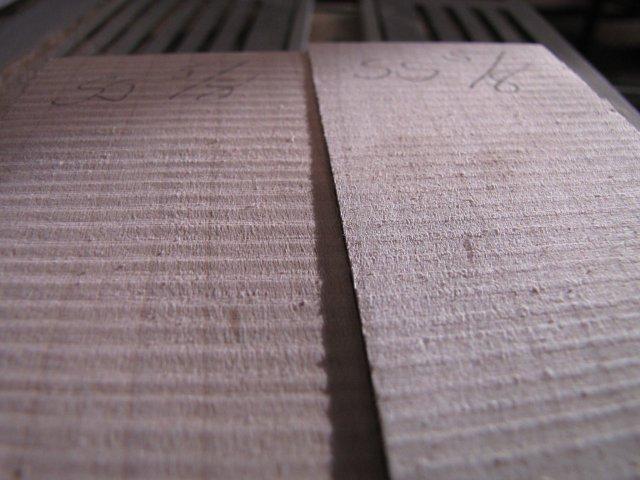

Here's a macro shot of the 2 slabs from the SS blade:

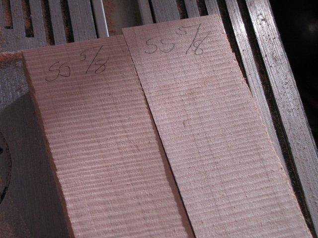

This one a little farther away:

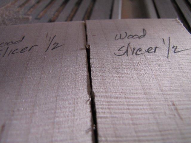

Here's a macro shot of the 2 slabs from the Wood Slicer:
[ATTACH]14753[/ATTACH]

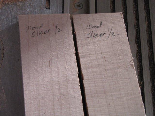

[ATTACH]14756[/ATTACH]
As you can see, the cut from the SS blade was not quite as 'clean' as the Wood Slicer, but is actually quite acceptable for resawing.
I could tell no difference in the width of the kerf between blades. Holding the slabs together and measuring with my calipers, they both came in exactly at 3/4". Both blades took out 1/32" in the cut.
The SS blade required absolutely no adjustment for lead. The fence was parallel to the grooves in the table.
I had to adjust the fence for about 3/16" difference end-to-end on the table to adjust for lead on the WS.
Which one will I use to do the back slats? The Wood Slicer.

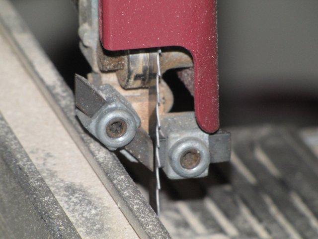

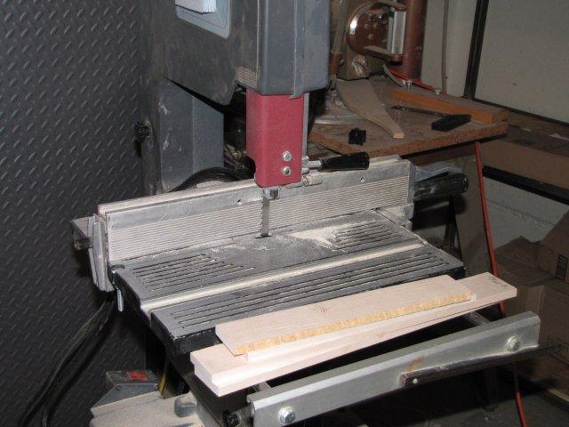

Hi,
I'd be interested in how your band saw is set up. Have you upgraded the guide bushings(cool blocks, ceramic), added the double bearings, or any other sorts of modifications of thing or is pretty much stock.
What fence system are you using?
I have yet to mount my woodslicer much less tension and adjust it on my shopsmith bandsaw. I have one that I have used on my other brand bandsaw and found it takes a bit of time to learn how to get it cutting spot on... the little part about the power on flutter test and getting rid of that last bit of jitter is key to getting really great cuts. I'm looking forward to getting to that point on the shopsmith, any hints you can pass along would be most helpful.

reible wrote:I'd be interested in how your band saw is set up. Have you upgraded the guide bushings(cool blocks, ceramic), added the double bearings, or any other sorts of modifications of thing or is pretty much stock.
Ed,
This bandsaw is stock...no updates, no upgrades. I assume the PO (Previous Owner) bought it as part of a package deal...the serial # on my 510 says it is an early 1998 model. The 5/8 SS blade (still in the factory package) was part of the 'package' when I got the system, as was the fence and table extension.
I've got it mounted on the SS power stand I bought in the early 80s.
