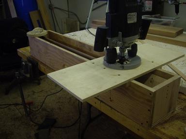

Here's the router lathe box with the router in place.
I used a Bowl Cutter to rout the cane.
[ATTACH]15179[/ATTACH]

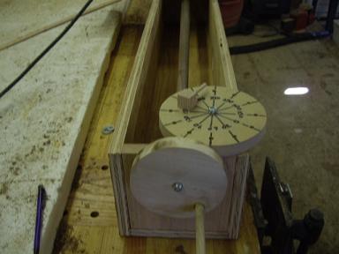

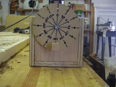

Here is the dial to locate the cavities for the inlay. The little square block is on the end of a 1/4" dowel through the dial and in to the box end.
[ATTACH]15182[/ATTACH]

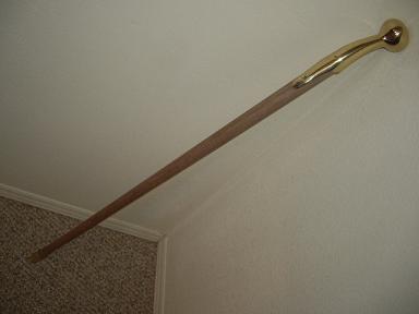

Here's the hame and end cap loosely fitted on the walnut cane. Good fit, by golly!
[ATTACH]15181[/ATTACH]
This is the crank end.
[ATTACH]15180[/ATTACH]

- Crank.jpg (57.12 KiB) Viewed 1951 times
- cane1.jpg (47.4 KiB) Viewed 1954 times
- dial.jpg (61.02 KiB) Viewed 1951 times

The dead end is just a 6X6X3/4 piece of oak with a hole drilled for the lag that holds the end of the stick. And yep, it's lower than the crank end by the amount of taper I needed.
There is no drive. Just crank the crank and manually move the router.
Thanks for looking.
