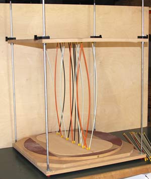

Post by jepello »
Yes, luthiers call them "Go-Bar Decks". Here's a pic of one. Looks like a fairly simple project to make.[ATTACH]15169[/ATTACH]
