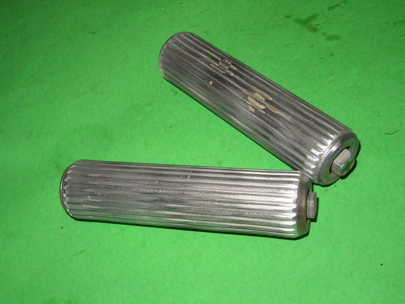

Proverbial
Not everyone can look at those schematics and cipher what they need.
So, here's a pick of the little rascals.
[ATTACH]15824[/ATTACH]
- AA Locking Handles.jpg (66.25 KiB) Viewed 1520 times
