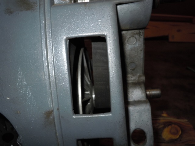

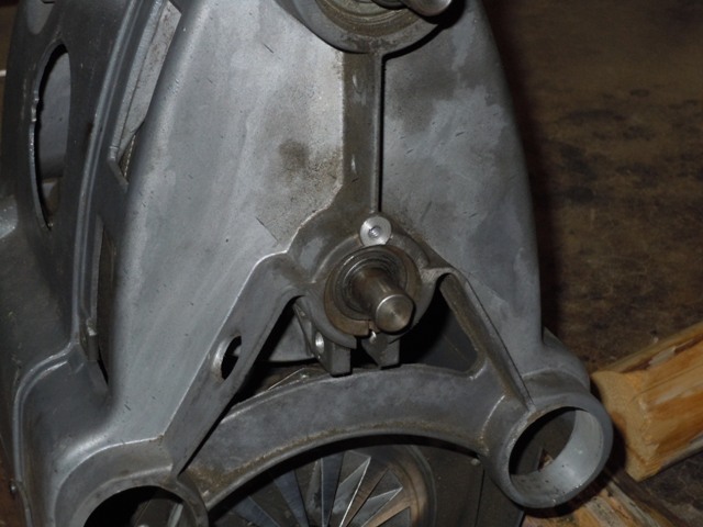

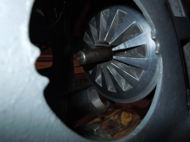

No, I mean the idler shaft. At least that is what Nick repeatedly referred to it as. The portion of the video I am referencing is at 16:30 of Sawdust session 22. Attached are some pics it just to make sure there is no confusion:JPG40504 wrote:The idler shaft is in the headstock.
I assume you mean the motor shaft.
The fan sheave and the floating sheave are on the motor shaft.
If it is gunked up, the floating sheave can be quite difficult to remove(for the same reason, it does not function well either).
Soaking and gradual movement will eventually get it loose. Prying should be done in a balanced manner. If you noticed, Nick was about to use a pry bar, but I would have used two(one opposite the other). Try to get the key and keyway well soaked. My favorite 'soaker' is kerosene, but there are other more 'exotic($$)' fluids that might work. Do not try to rush it, let it 'soak' overnight at least.
[ATTACH]15953[/ATTACH]
[ATTACH]15954[/ATTACH]
[ATTACH]15955[/ATTACH]
What do you mean by soaking the shaft? If it is still in the headstock I can't submerge it.....do you mean applying kerosene with a cloth and letting that set overnight?
Thanks for your help. This is my first time taking a headstock apart so am still trying to learn all the terminology and figure out exactly how everything comes apart. Would probably help if I had the owners manual.....but it didn't come with my machine and I am too cheap to pay for it at this point.
