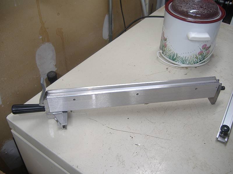

Looks like you missed the upgraded 500 fence with t-slot on top etc.
For future reference here is a picture of mine.
[ATTACH]16050[/ATTACH]
JPG40504 wrote:500 - Rip fence has NO slot on top and smooth sides and three 1/4" holes in the sides and a 5/8" hole on top.
505 - see 510
510 - Rip fence has a single t-sliot on top and ribbed sides and three 1/4" holes in the sides and NO hole on top.
520 - Rip fence has two t-slots on top and a feather board slot on reach side and NO holes on sides or top.
A 500 will have a single auxiliary table.
A 505 - see 500
A 510 will have two floating tables and an auxiliary table and tubes.
A 520 - see 510
The quill you will have to gamble on.
The auxiliary table will be narrow for early 500 or may be wide for later/upgraded ones(not a good indicator).
Not sure if a seller who 'does not know' would be much help describing the round/square 'rails', but that might be worth a try.
The table dimensions will cull out a 500.(14w x19d)
- DSCF2908sc.jpg (63.43 KiB) Viewed 1946 times
