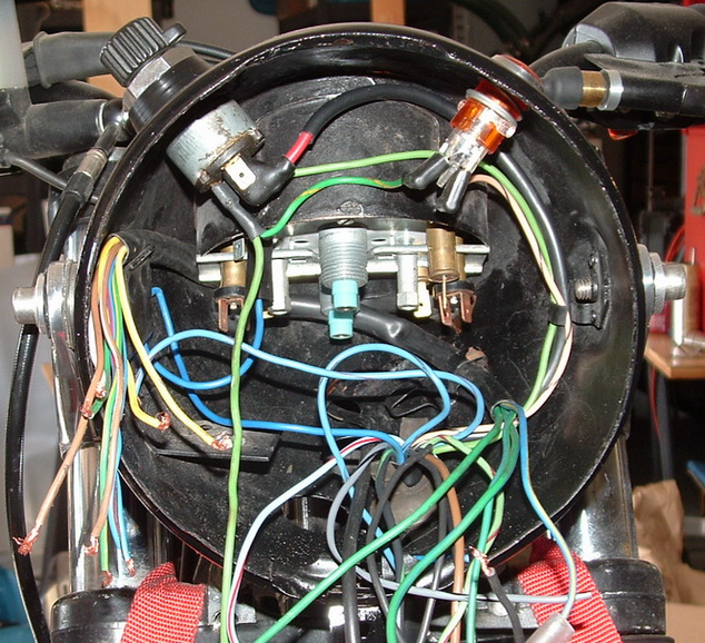

Here is a pic of what I do, and a link to my website. I learned this crap as a young man laying upside down under the dashboards of various german cars. Mostly Porsche and VW and Audi.
It's no wonder I have a pooched back.
